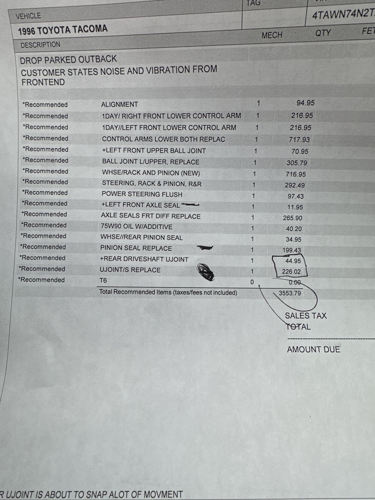

    The service advisor seemed to think the Lowe ball joints had to be replaced along with the LCA bushings, which I didn’t think was the case.

    Kwikvette
    Feb 27, 2019
    #284735
    81,709
    Fresno County
    4 run, 2 don't
    Holy fuck
    $265 for replacing the cv axle seals?
    That's a $10-14 seal and a 15min job each

    I think it was the seal on the front diff where the axle goes in.

    No fucking shit; it's a 15min job my dude
    A bit longer for gathering the tools, but once jacked up, it's undoing the LBJ bolts and letting the spindle droop down, yanking out the CV axle, and there's the seal

    Not to mention half the work is done already when they pull the LCAs..
    It looks like they charge full labor for every part, not taking into account the fact that that part may already have been removed to get to something else

    I’m still unclear if I need new LBJs then, or can just get away with replacing the bolts. The ball joints are just something that everyone says not to mess around with when you’re in doubt.

    For sure, that's a whole "while you're in there"
    And it's pretty standard cause they'll use something like Alldata, and just add each job (parts and labor) and bill it out on said sheet
    Then SOMETIMES they'll tell the customer when they arrive to pay "hey, I was able to save you some $75!"
    Customer is now super stoked, still overpaid, and will recommend more people to said shop (and use them again themselves)

    They're oem with 20k on them, I wouldn't worry about them.
    Theres also no accurate way to test them anyway, so to hear that they saw a need for replacement based on condition (unless they are visibly in bad shape with rust or torn rubber) tells me they're just tacking on as much as they can
    Or they just assumed they're old judging based on the age/condition of parts around them

    The guy seemed to think they had to be replaced with the LCA, but I didn’t wanna argue with him on that.

    Some guys test them for play with a crowbar, but that doesn’t seem foolproof either. It’d be rare to fail that soon - usually that’s only with extreme use (like jumping, racing, etc.) that they’d go bad that quick.

    And I've seen people talking about routinely checking for play like that, never seeing any, and still having a BJ failure. I don't trust any test, just replace every 100k and more than likely you'll never have an issue.

    All of this could be fixed for the cost of parts plus the alignment and time watching youtube how to videos. You don't even need anything more than basic tools and a small jack.
