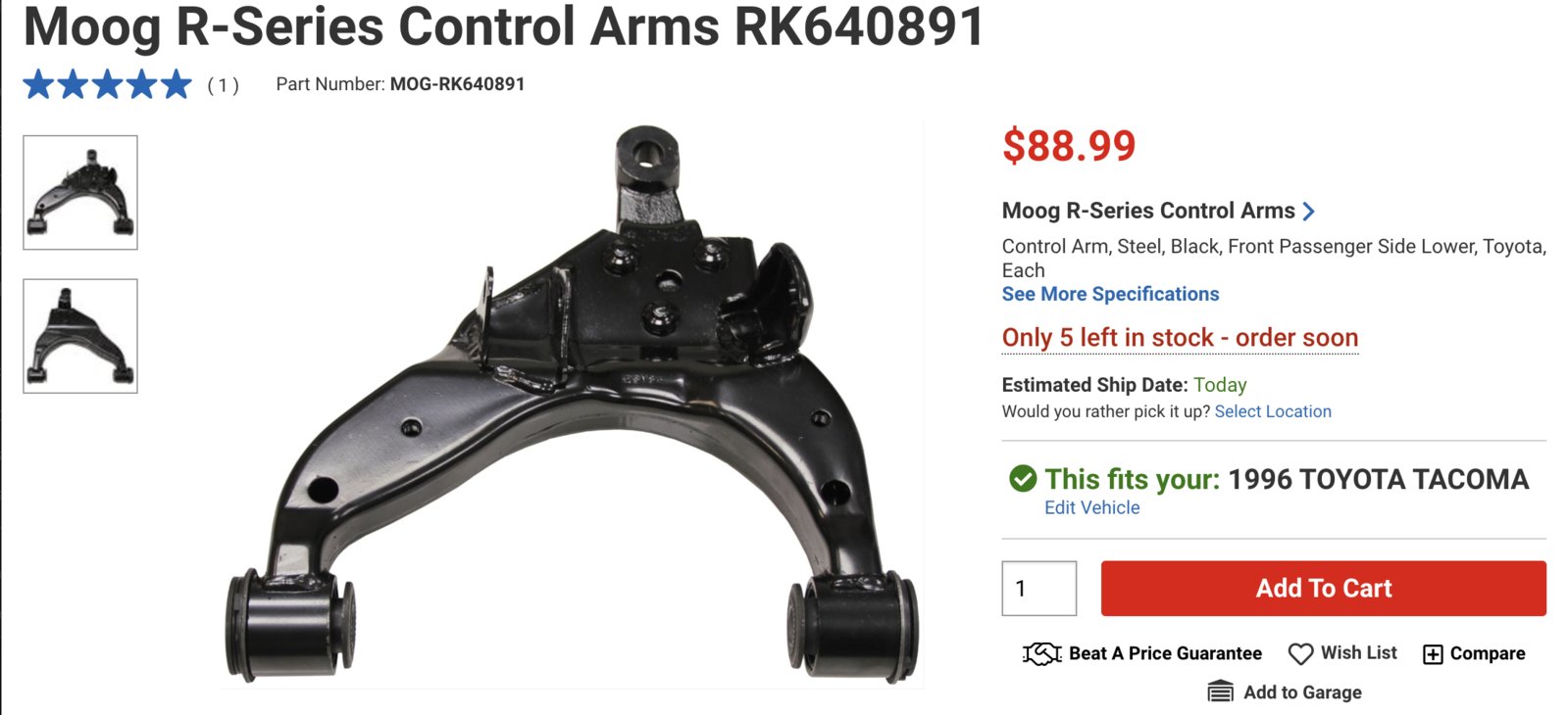

    Literally the exact arms I'm running on my truck, with the last set of OEM ball joints ill ever buy
    Ozark_RegCab[QUOTED] likes this.

    At least swapping bushings out of brand new LCAs should be much easier than old ones, so if you do need the actual LCA you can put oem/whiteline bushings in.
    04Pre_Runner[QUOTED] likes this.

    The guy also quoted new upper ball joints. Does this mean I need new UCAs as well?

    100%. I’m sure those duralast arms would’ve been fine if I’d just swapped in some decent bushings. I ended up bending them with the bottle jack method when I had a perfectly fine 20 ton press in my garage. So off to scrap they went.

    UCA are pressed into the spindle not the arm, so no

    I haven't heard much about upper ball joints and what's involved in replacing them, since everyone's always going on about the lowers.

    remove snapring, press joint out, press new joint in, put snap ring on. doesn't get easier
