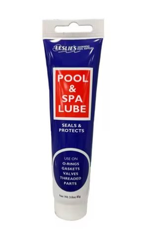

    Everything but the driveshaft. B03A - 410
    Have you guys ever used this?

  19. Apr 5, 2024 at 6:52 PM

    Every time I see one of these out I realize I've forgotten they exist. Such a weird flex.
    ( @Sperrunner go get one)

    Only things I've bought from Leslies are chlorine testers...
