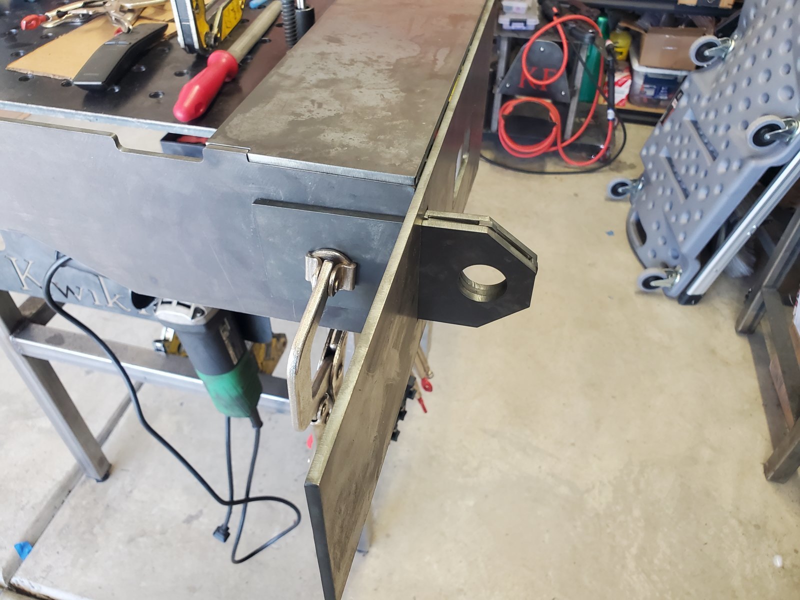

    Cutting shit on CNC is so much more convenient
    Making a rear bumper :anonymous:

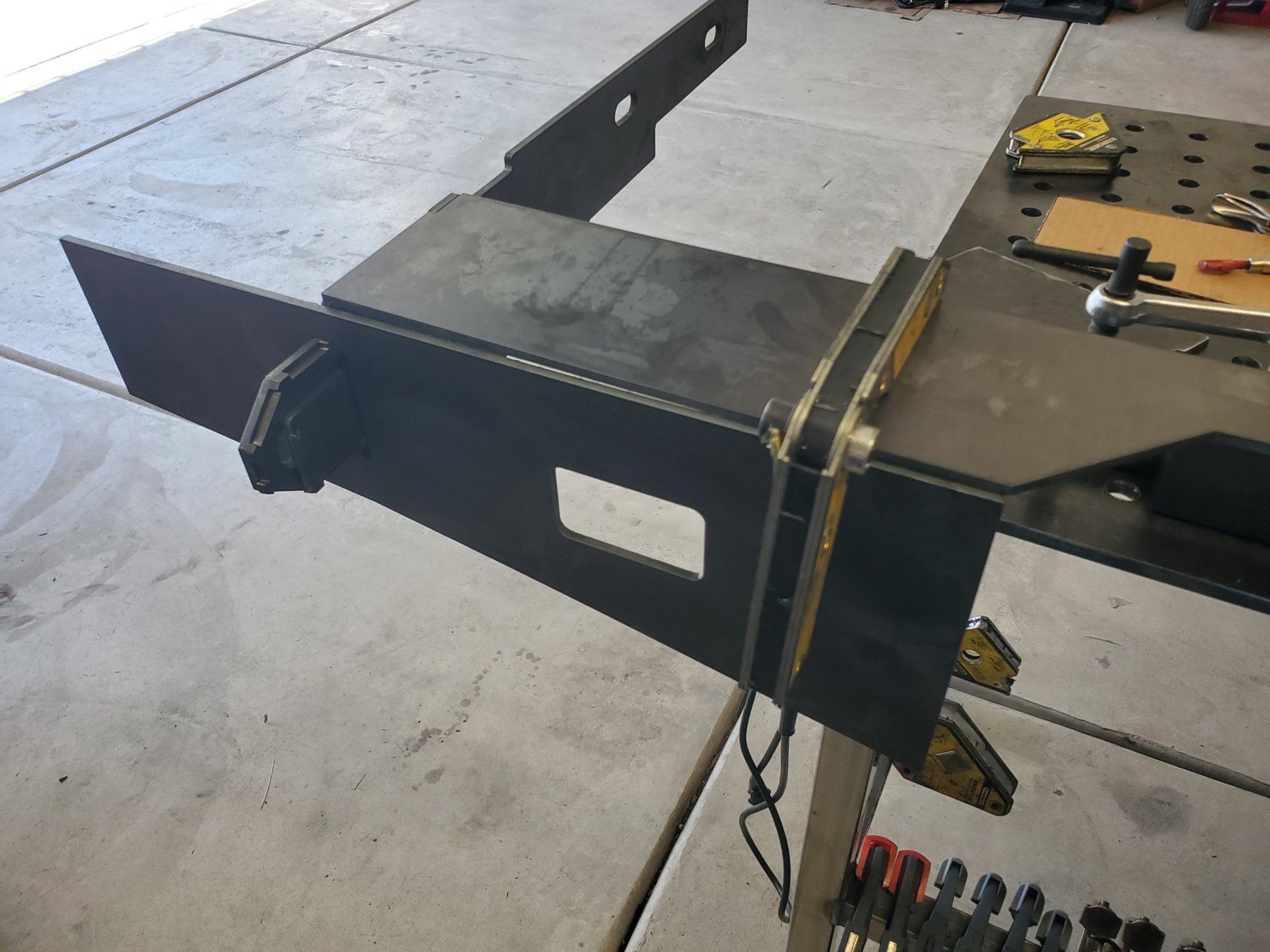

    I still have it LOL gives me strength :rofl::muscleflexing:
    Some Baja Squadrons will be mounted to the rear, just need to extend the recovery point so I could weld it to the frame mount on each side

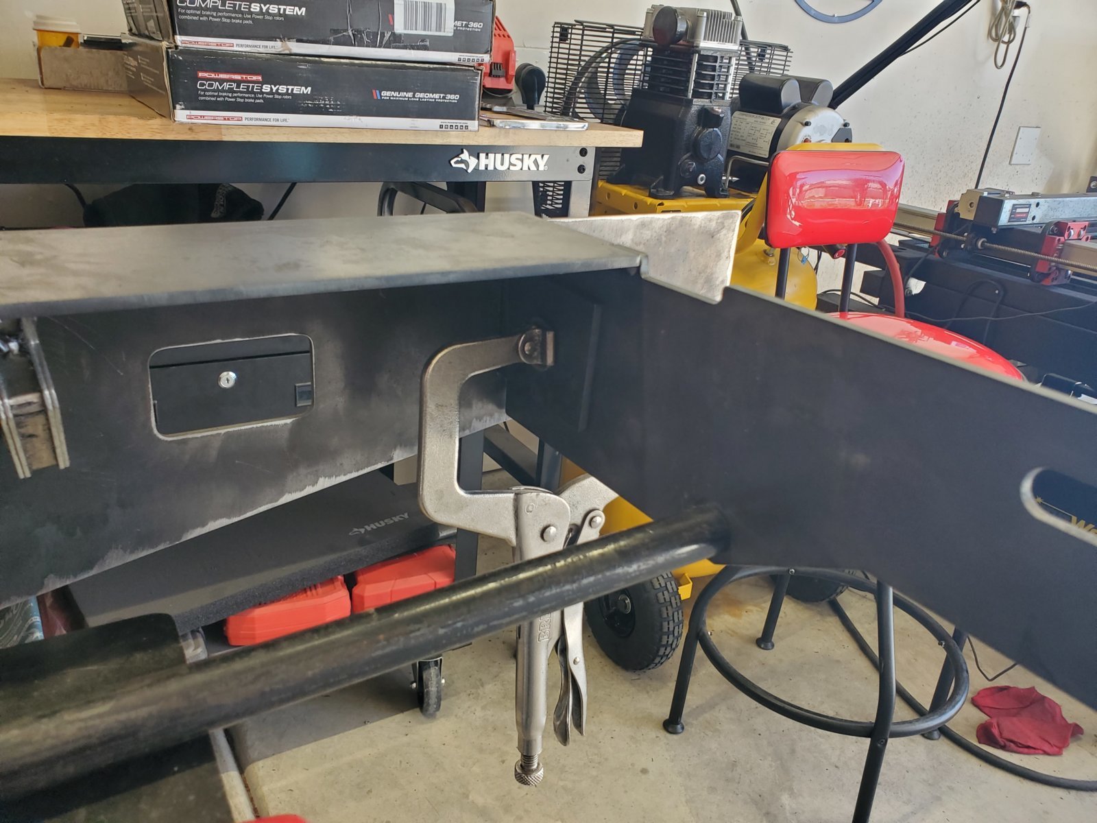

    Much better
    Ignore the pipe; that's going to be replaced with larger DOM but this maintains the width of everything as the outer parts are tacked together

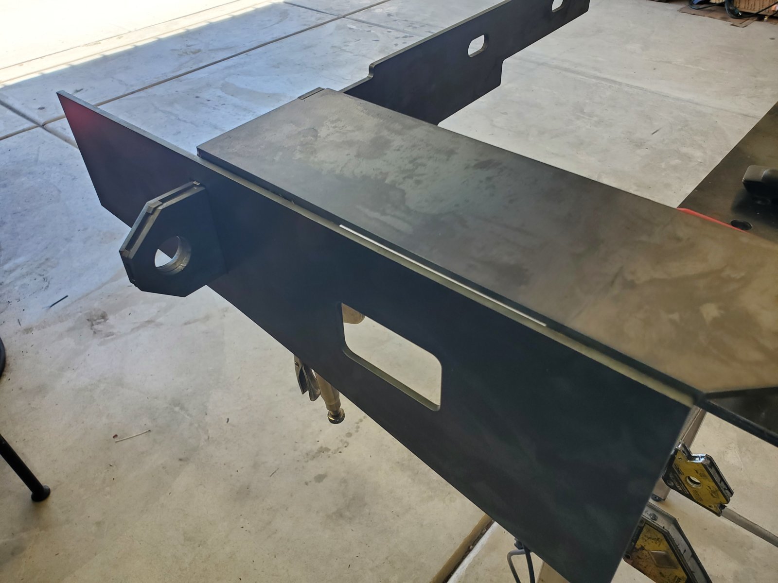

    I need to become friends with anyone that can run and has access to a 100 ton brake
    Would rather have a single front panel for the plate but it'll have to be split up in 3 pieces

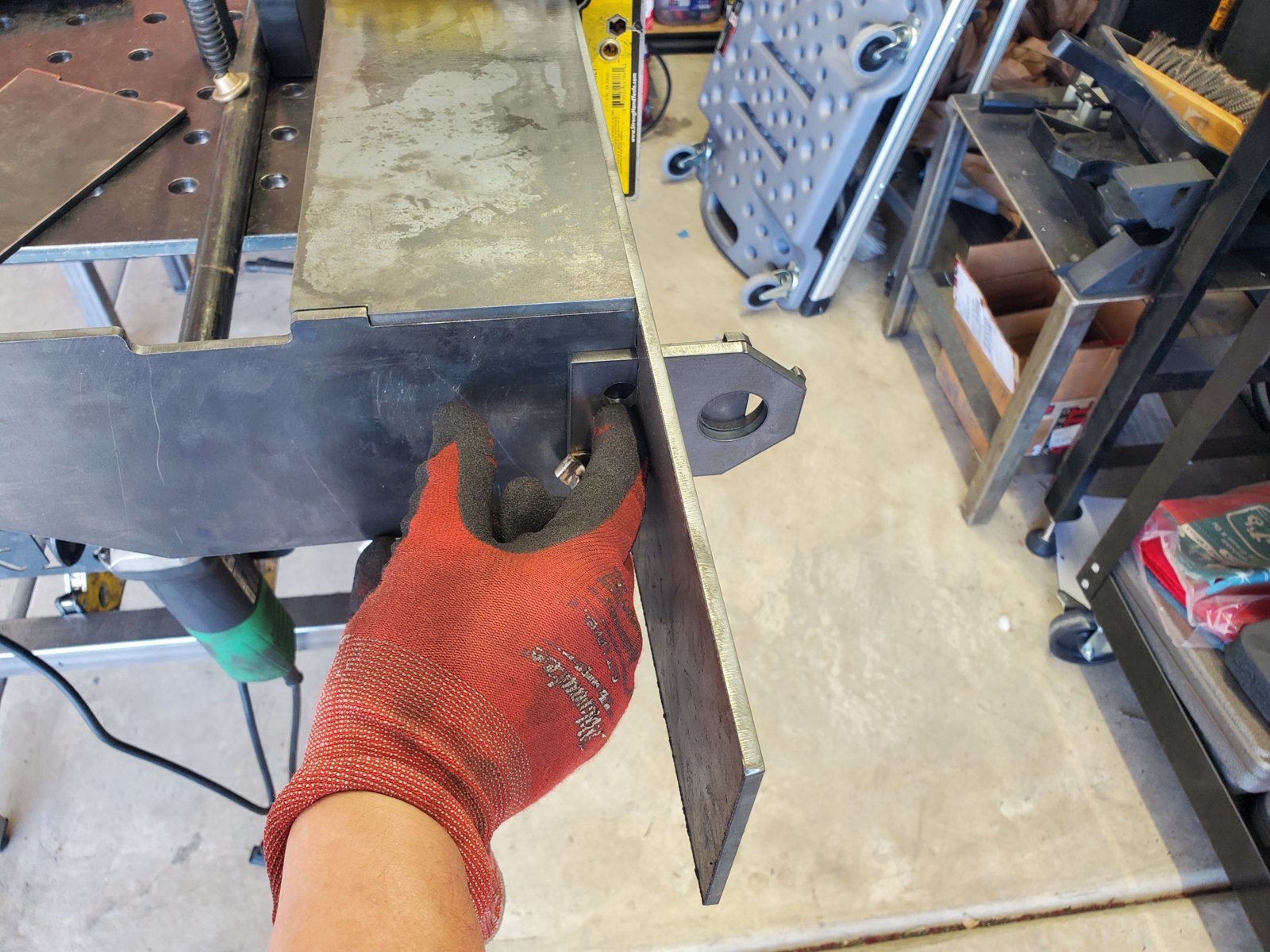

    Don't expect to make another after this one (due to the many still available from vendors) but it'll be nice to have the blueprint created knowing it works
    The pieces are all meant for open corner welds
    Recovery points fully welded, in a better fashion than say Coastal Offroad (but same concept with the sandwiched portion)
    Just having fun with the whole thing!
