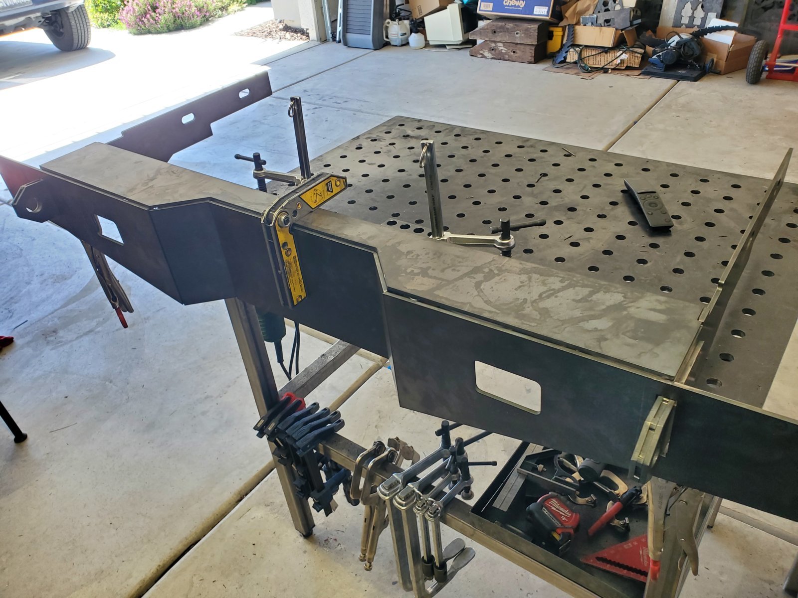

    Who's plans are these?
  2. Apr 28, 2024 at 12:09 PM
    Kwikvette
    Feb 27, 2019
    #284735
    82,872
    Fresno County
    4 run, 2 don't

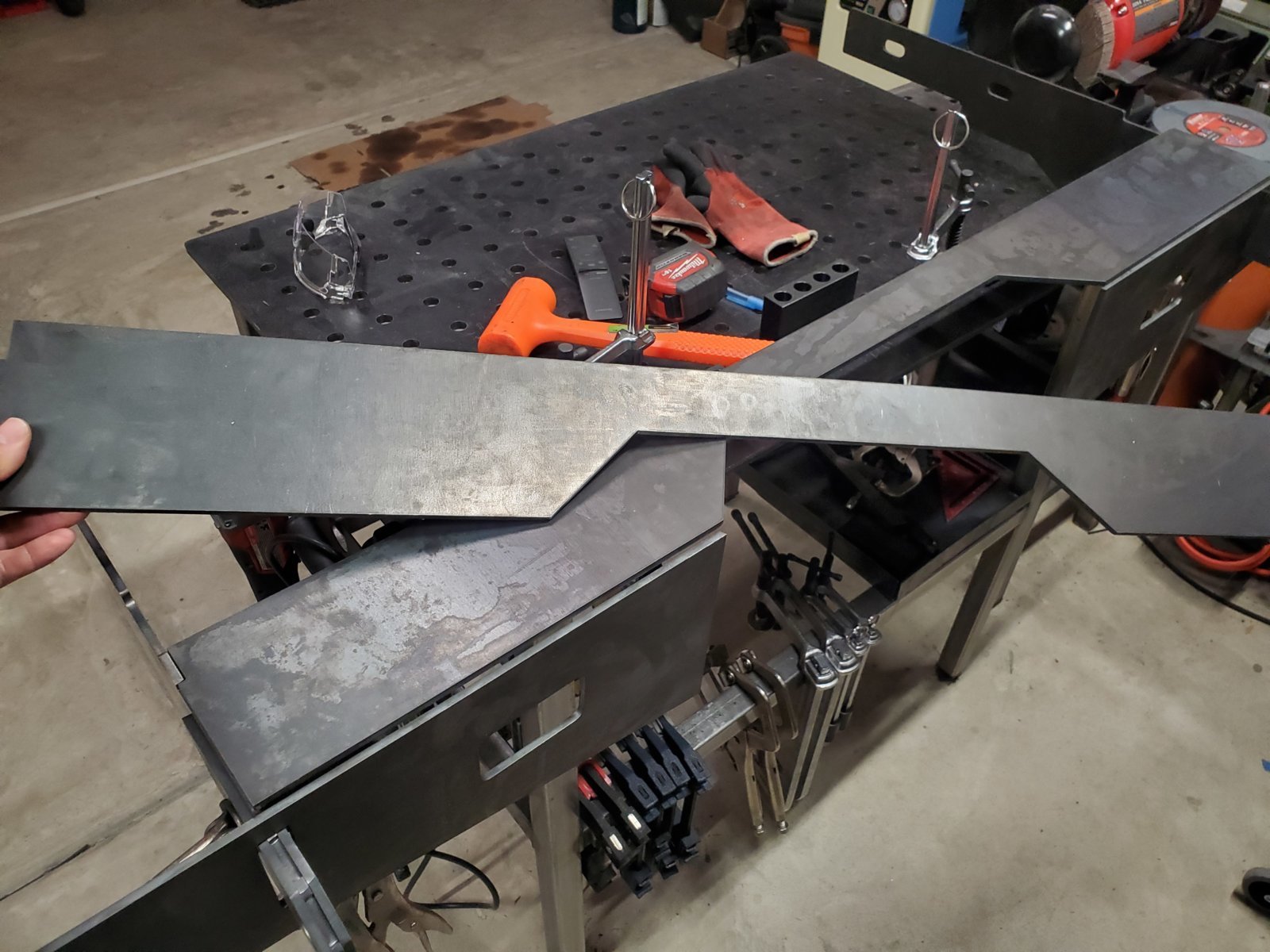

    With the exception of the "frame mount" rails that I modified, everything else is from scratch
    Was doing the "face" with cardboard, followed by doing two separate pieces out of steel, and adjusting the final dimensions for a perfect fit
    The top plate was the biggest waste of steel as I had misjudged it seeing as how I was trying to measure shit at a really odd angle directly off the truck (with no parts cut)
    Because, from scratch lol I was off by about 1/2" :bananadead:

    The frame mounts look like the one from overland under budget, bumper looks like it'll be nice though

    Yeah that's where Adrian got it from, the rails itself he bought/downloaded and sent to me
    I shortened them, changed the height and adjusted a few other things
    Also not going to use the bottom frame mount he uses, I'll incorporate my own with the frame mount
    But I screwed the pooch on the top piece lol luckily we got plenty of steel
    And thanks!

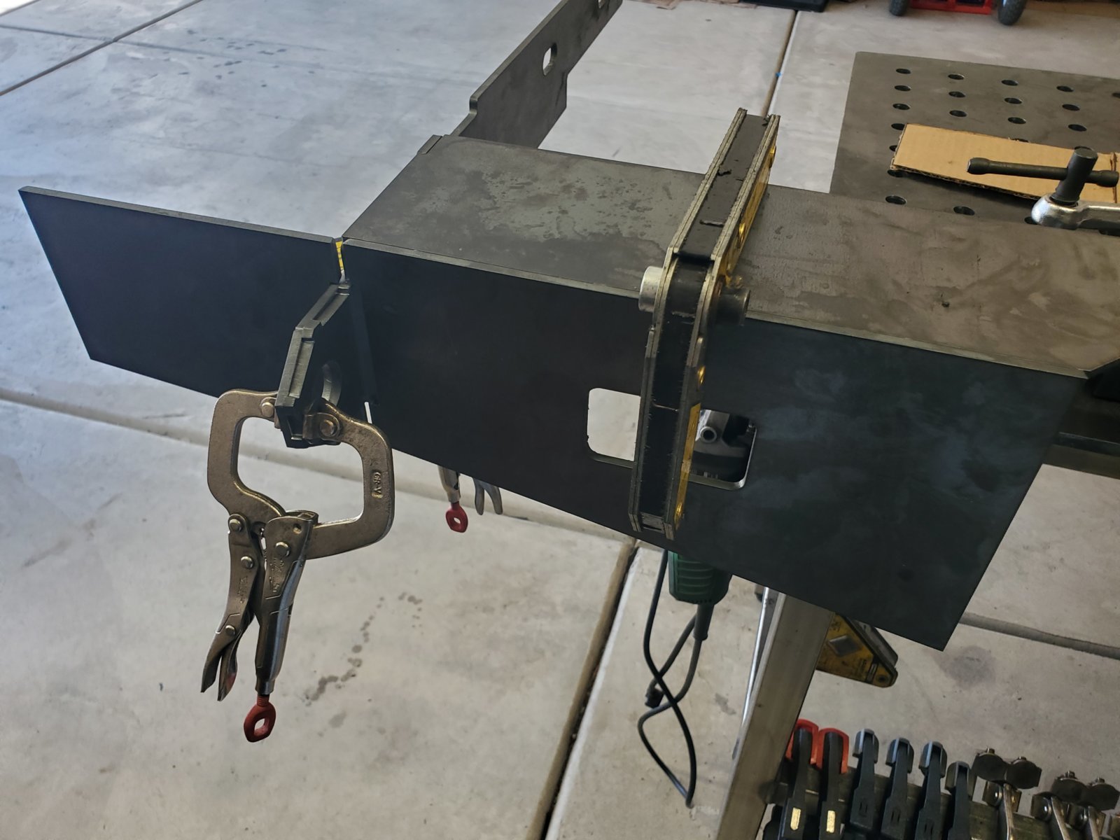

    Bulk of it is done
    First step is to weld the recovery points
    Need to get some Baja lights to ensure the sort of clearance I need for mounting them; that'll allow me to move forward with creating the gussetting plates for behind the face
    Then drilling the front license plate frame both for the license plate as well as the two LEDs provided
    Then tack all the frontal pieces, ensure everything is aligned, and burn it in
    I'll then start working on the "bottom" to close it up and provide a surface to scrape against when dragging against rocks
    Then onto finishing the wings
