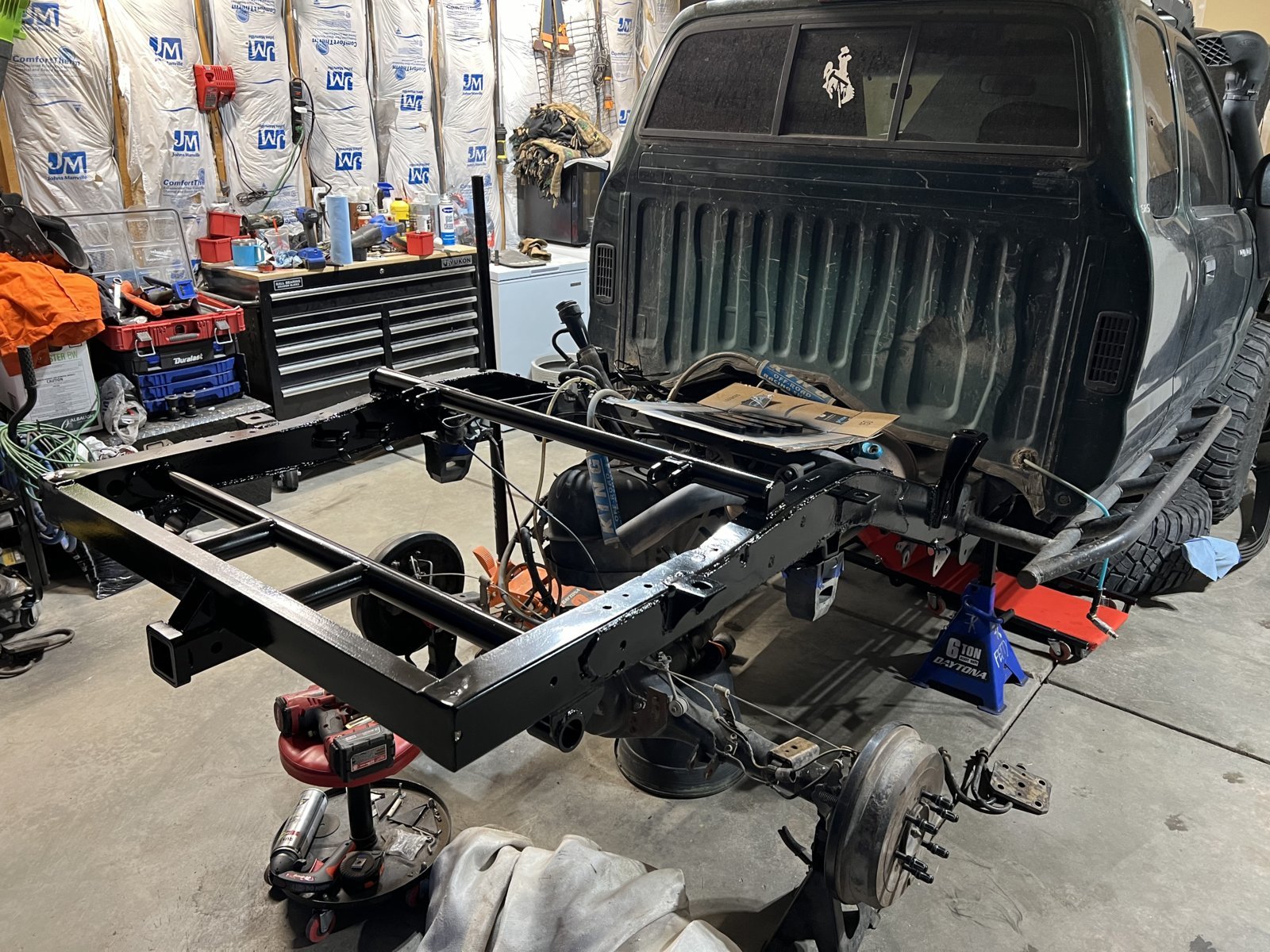

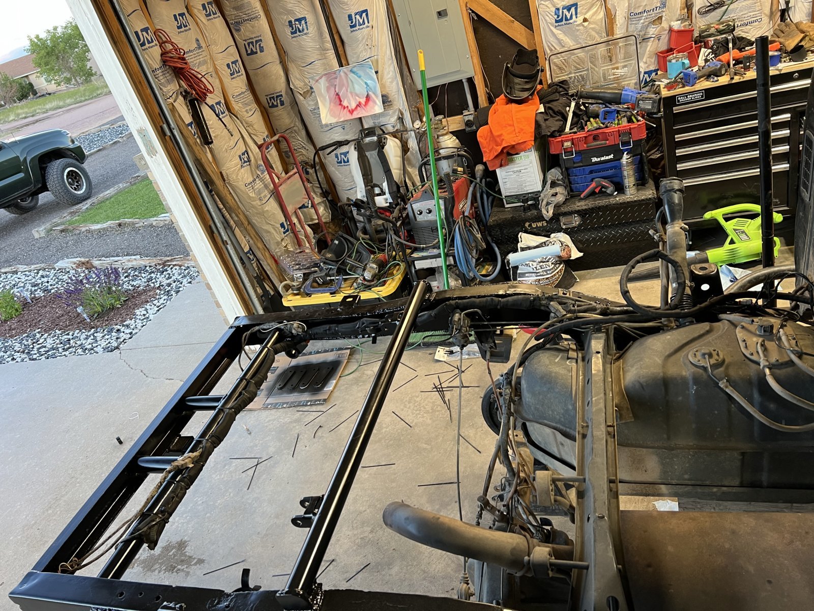

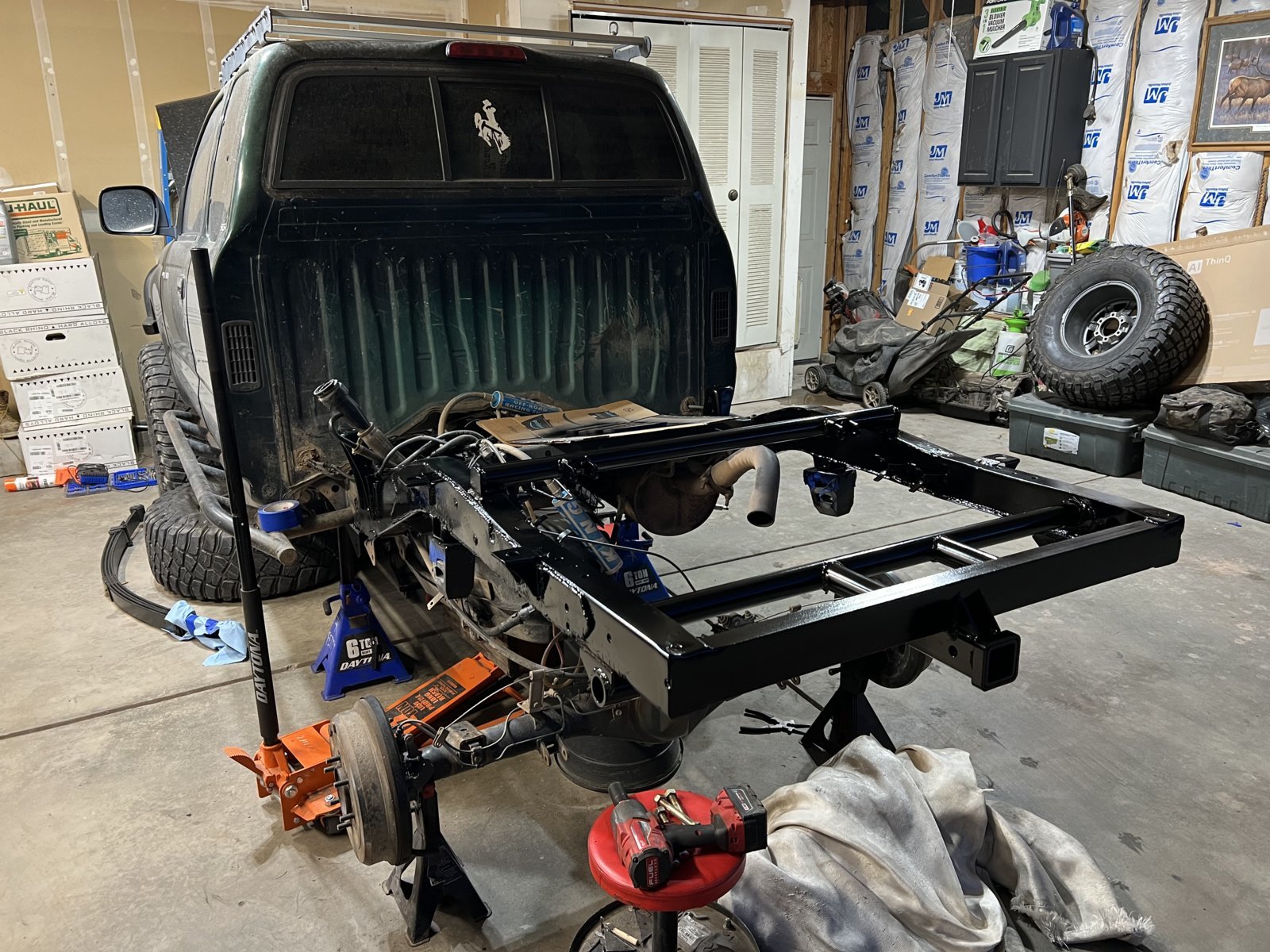

    Thats what i was thinking about. I havent cycled yet but i know the droop is gonna be my issue (a good one). I was going to try to run my 10" kings still but I would need to reposition my lower mounts and id be limiting a lot of articulation. I was debating short body 7100 short body 14s. Again though. I need to cycle to see what my numbers are. Upper mount is already touching the bottom of my flatbed so Im gonna leave that where its at.
    Good news that ive finally painted my frame from the boxing, upper shock mount V2, frame strengthening from when i built the flatbed in '21. Havent painted the flatbed yet though :rofl:

    Can those frame reinforcement plates be welded on without pulling the bed?

    You could potentially throw a couple beads here and there. But to fully weld everything, bed needs to come off. Worth the extra 15-20 min too. Just need an extra set of hands to lift it off.

    This.
    Totally worth pulling the bed off for welding anything underneath.
    It's pretty light, just awkward due to its size.

    4 bolts (bed), 4 screws (Gas fill door ), Unplug your lights and detach the loom from the lip on the bottom of the bed. AAAnd lift.
