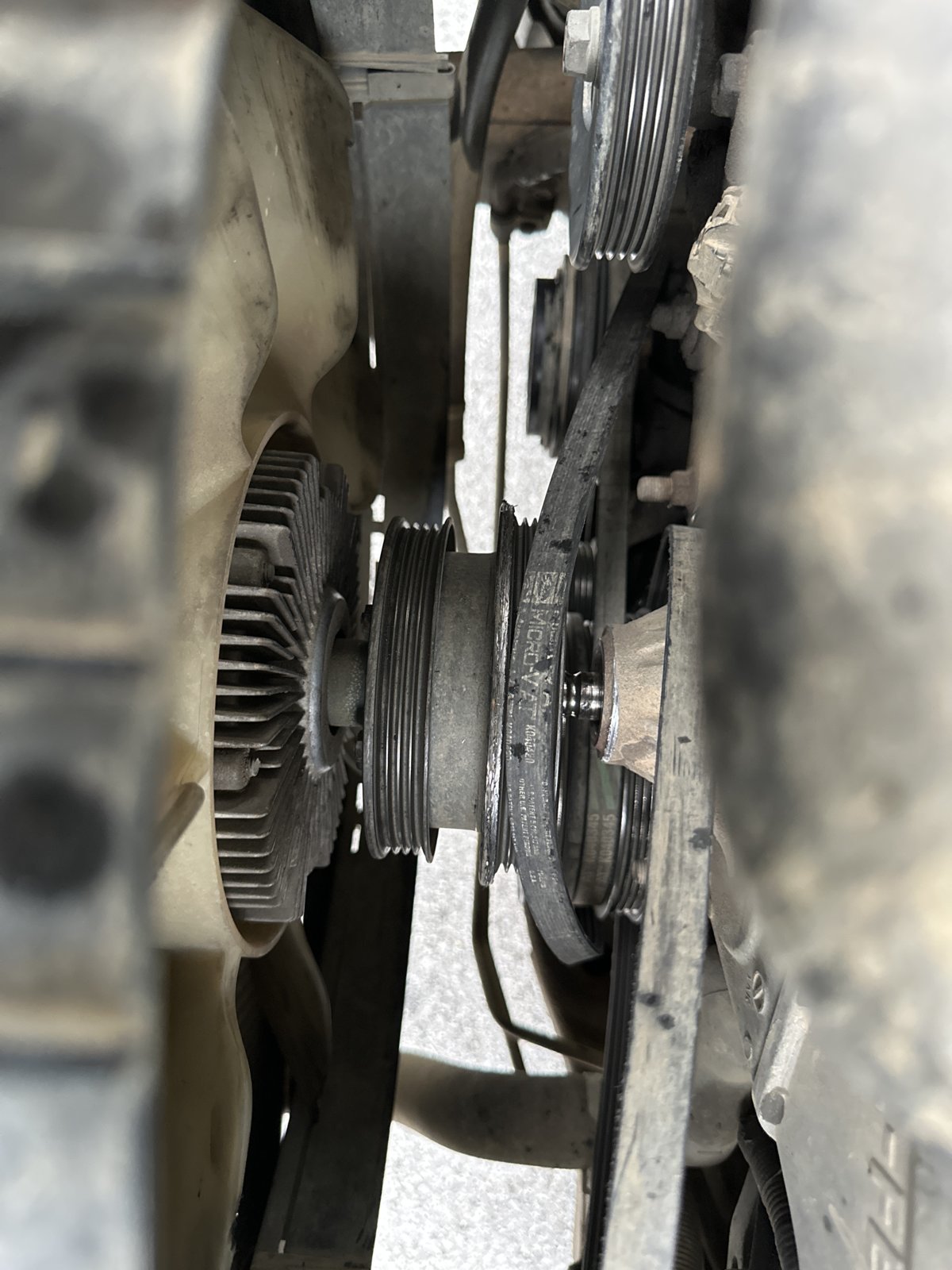

    How the fuck does this happen.. idk what to do since I’m stranded in Fayetteville

    Is this something easily fixed in a parking lot, or should I get a tow?

    Is it the studs that sheared?
    It's easy to back them out when the nuts holding the fan clutch are torqued down really tight.
    If you've got the studs intact, it's as easy as just undoing the nuts, putting the studs back in, and bolting on the fan clutch again.
    Super easy parking lot job.
    Definitely put some loctite on those studs so they don't back out again (assuming they're intact).

    Disregard, it pulled with the fan clutch
    Yeah that's just the pulley it bolts onto
    Hard to see on phone

    I really just hope I didn’t catastrophically overheat it. I had noticed a lack of power steering and better light for a few hours, but I thought that was just the rack and alternator going out. Surely it would’ve died on me if the belts were off that whole time.

    Vehicle died before overheating otherwise your fan blades would be in pieces from having fallen off

    It actually never died, I started it up and opened the hood to investigate a noise, and I guess the belts must’ve fallen off when I opened the hood.
