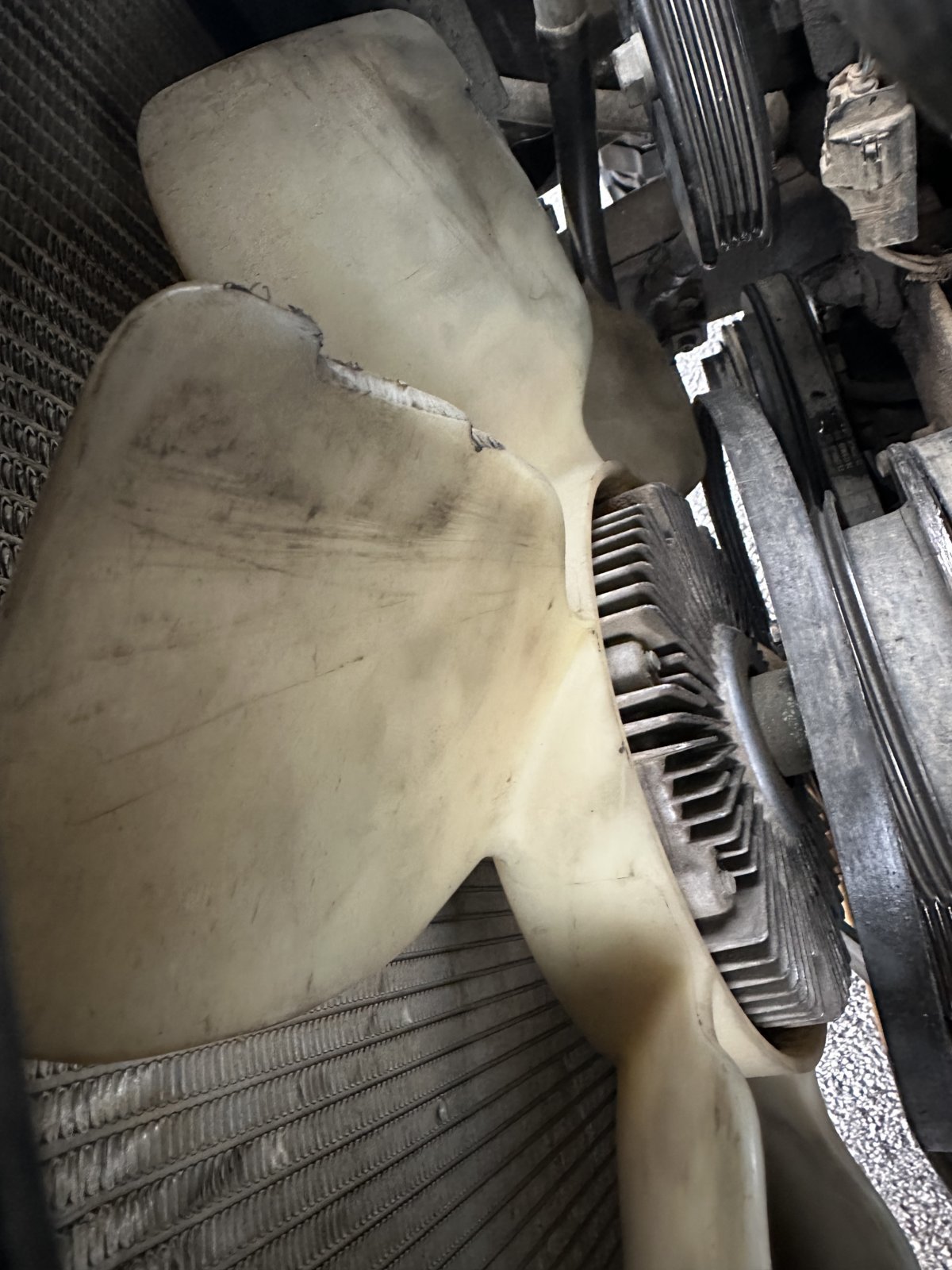

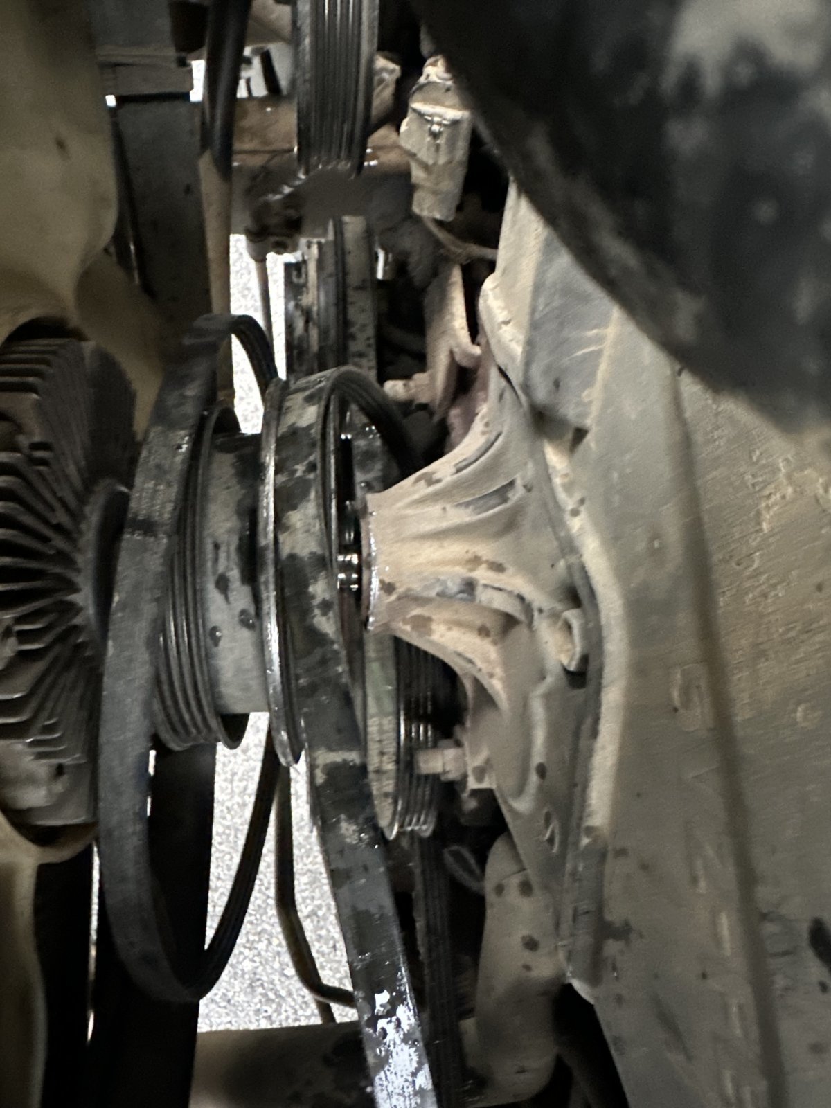

    Yea I just fast some grooves in the blades. I think it had been loose for a while. And just finally gave out yesterday. If there is major damage, it’s my fault for not paying attention and putting two and two together when the alternator and power steering gave out yesterday. I was just focused on an interview, so I wasn’t paying that much attention to it.

    Looks like just the fan bracket bearing gave out, that's an easy replacement.
    https://www.rockauto.com/en/moreinfo.php?pk=1871554&cc=1278930&pt=11548&jsn=2318

    It makes sense to replace the fan clutch at the same time like Kwikvette said. It’s too bad I didn’t notice it in the driveway, since it looks like such an easy driveway fix, but I panicked and had it towed to the shop yesterday since I was down in Fayetteville.

    It's 4 nuts that attach the fan to the clutch, and since the bracket will get replaced anyway all parts need to be disassembled
    It's a fairly quick, parking lot repair
