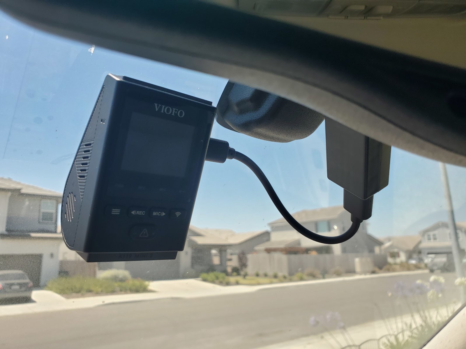

    Decided to throw a dash cam on the GX; see a lot of stupid drivers so figured I'd get something for the event of a "just in case"

    An Amazon special Viofo A119 Mini 2
    Most recommended single channel setup that actually records good quality for under $200
    Above that price point, you'd be spending more for 4k video, cloud service, and more (which I don't want/need)
    I didn't want to take up a 12V plug nor did I want to run a cable so I got a plug that pigtails off my rearview mirror
