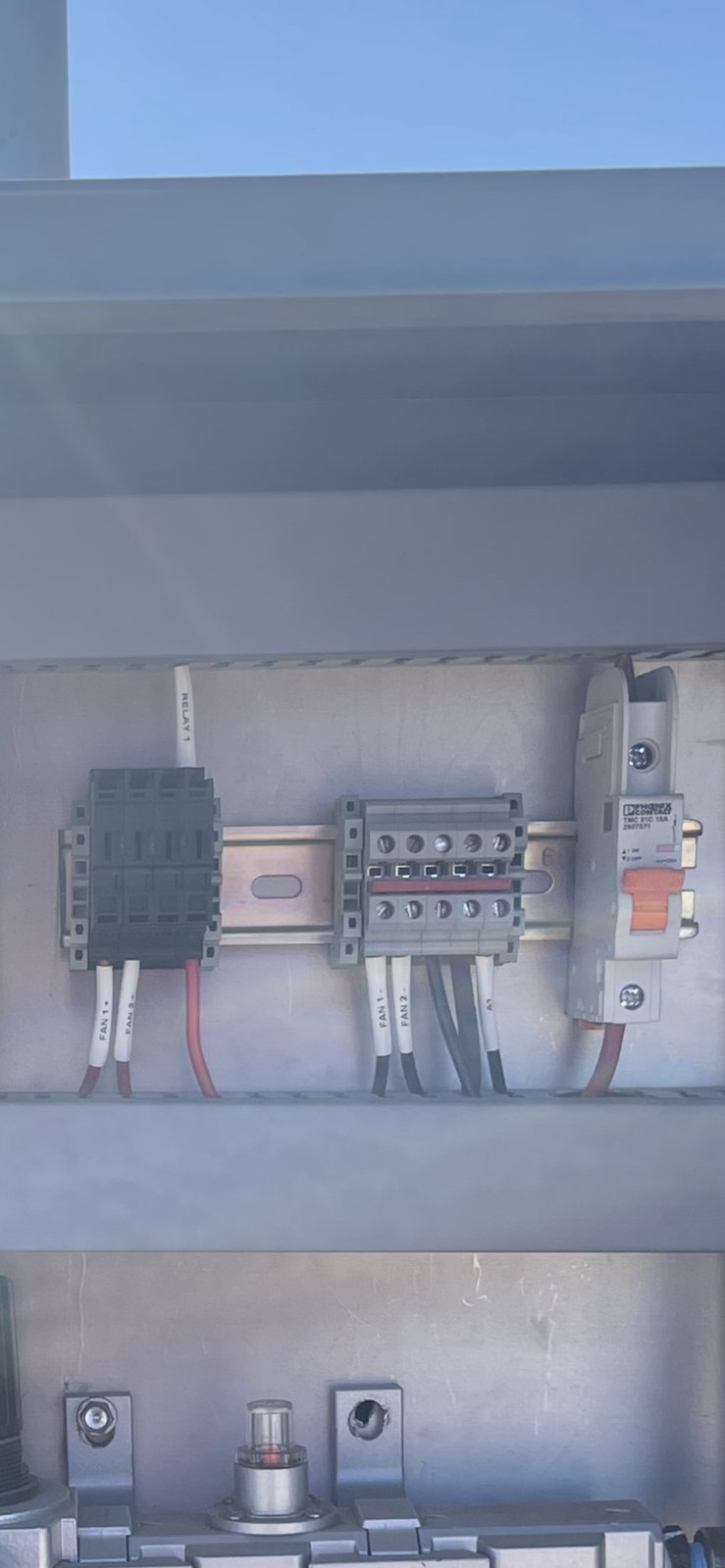

    What're these

    Well, there's a number of names (different industrie from what I've seen but I think terminal blocks or gang box connectors or the sort
    Normally used for, well what you're doing, routing power/data cables for say DIY cnc stuff, and more

    Perfect, jus needed a name haha

    The rail is called DIN rail. And you can get a get different things that clip on it like those terminal blocks and breaker pictured

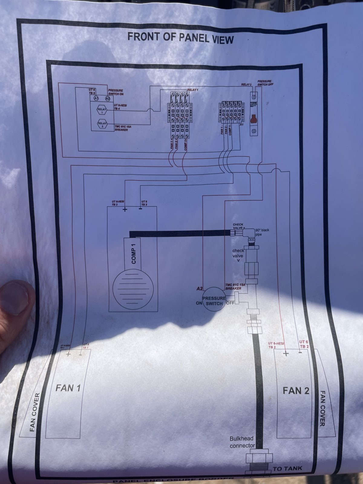

    Terminal blocks appear to be Phoenix Contact #3044102, (red piece is a jumper bar, PN 3030349) breaker PN should be on it, and the far left appear to be the fused version of the terminal blocks, possibly #3046090. There is more than likely another red jumper under the fuse holder on the top side of the fuse. Fuses will be 5x20mm, a good part number is a Mersen GDG_ (fill in the blank with the amperage). Appears that Relay 1 is what turns on both fans, I imagine relay 1 is controlled by a panel thermostat.
    Could be wrong on all that, take it with a grain of salt.
    Edit: Terminal blocks are for the neutral wires, fused blocks for the control power distribution. Relay 1 must be used as a master control relay.

    Yup. I've had to wire some of those that had well over a hundred wires, while a pain in the ass, it's quite brilliant of a system.

    Now make me a diagram of how to wire everything up ha
