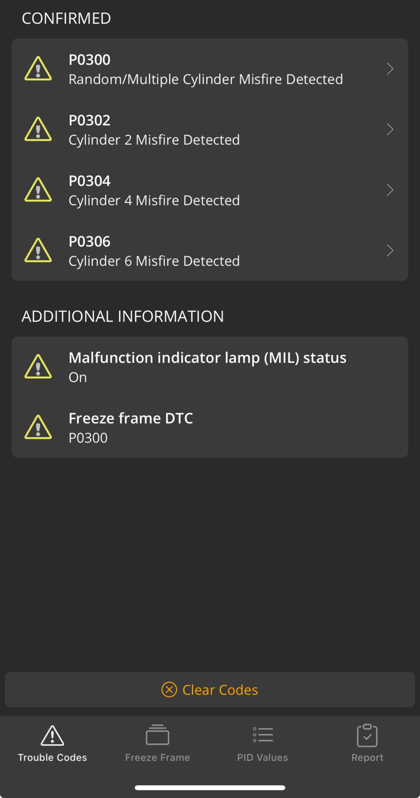

    Ok fuck now I am getting misfires big time. The truck was stumbling when I accelerated and had a weird growling noise. Gas fumes smelt weird too. Shit maybe I blew the head gasket when the fan came loose? It’s not overheating though..

    That’s funny, but I’d like to actually know what’s wrong. I didn’t see anything wrong with the wires on the right side of the engine, where the misfires are coming from.

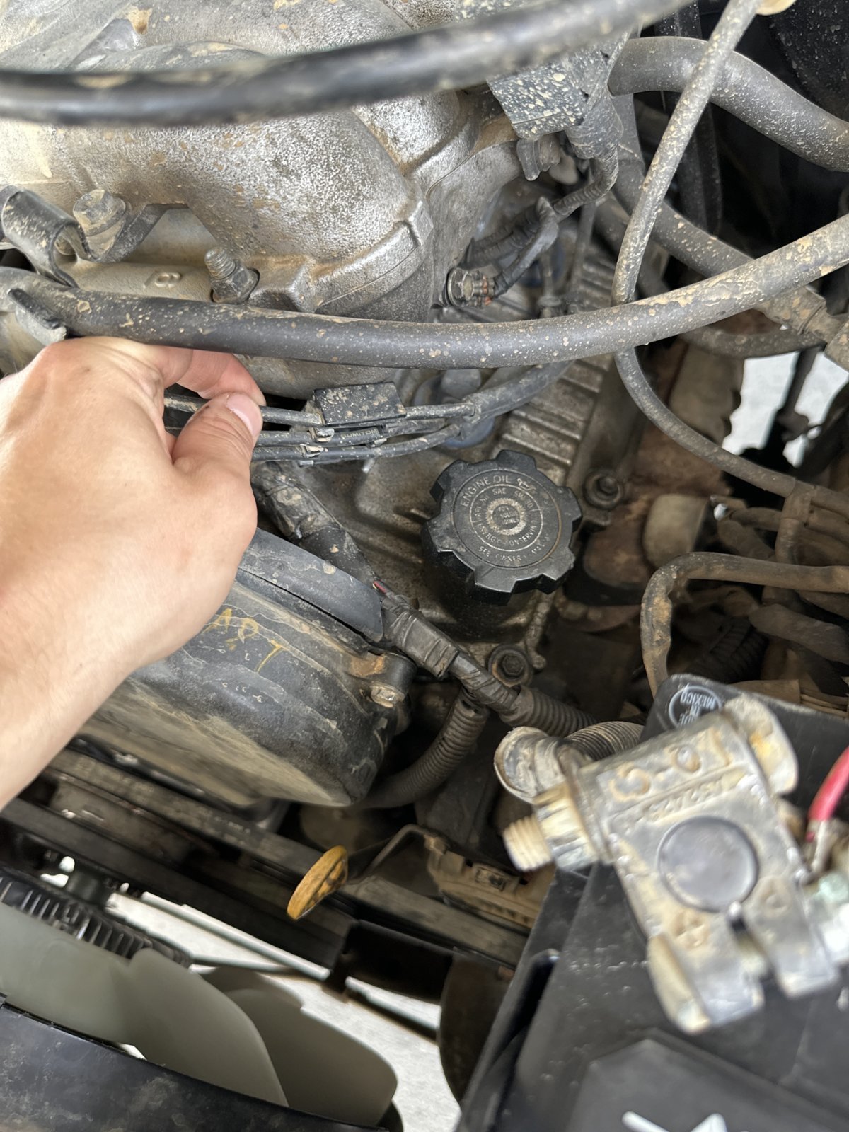

    Yea I didn’t see any nicks on them. I did think it was weird how only one side of the engine was misfiring

    Maybe double check the plug wire order, that could cause a one-sided misfire

    2, 4, 6 are all on the pass side check your plug wires again lol

    Looks right to me

    Is that ground wire connection right of ur hand secure? Kind of looks loose
