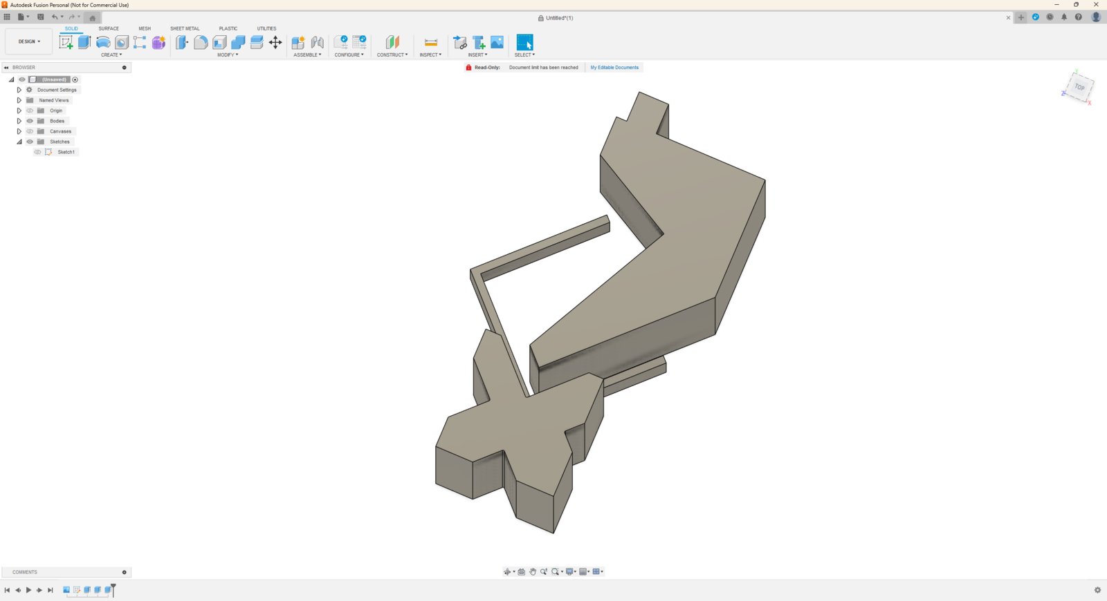

    Here's just toying around with gooseneck sizes and clearance

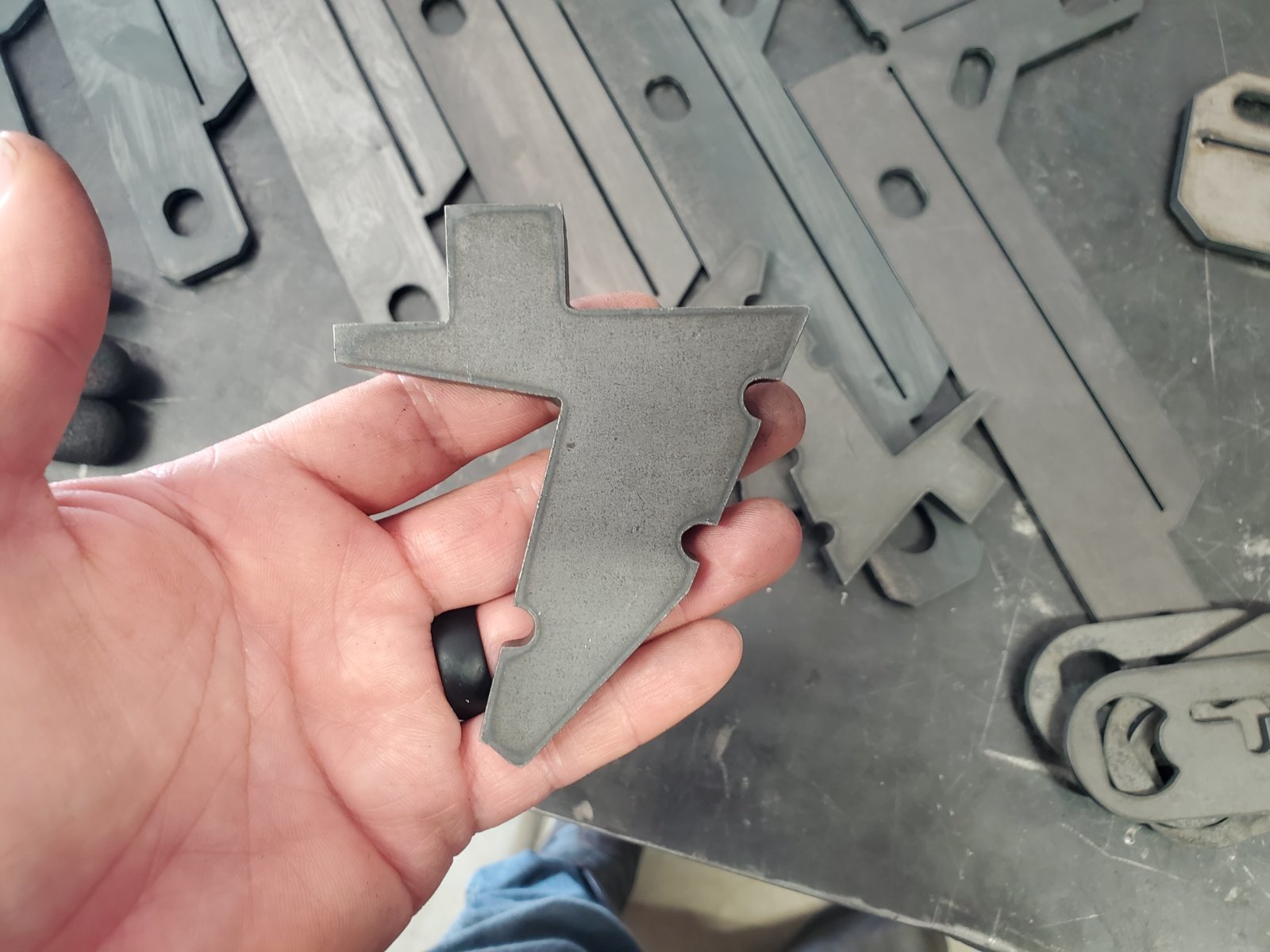

    I've already gone that route and used them before (old pic)
    But I'd need to do a final touching up to ensure everything is perfectly aligned with each other; I'd make multiple and weld them as needed to make different length dies
    If I go say, 24" to 36" wide, it'd be less trouble just buying a used die that fits my needs
    Can save quite a bit of money going that route

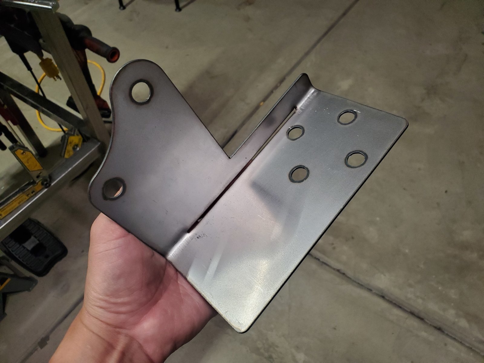

    Lately I'm bending very little and have been doing so with relief cuts I incorporate on my plasma table
    Whether it's thick or thin, but I do it often that I have a rule for how much to leave on each edge before the cut to prevent any deformation - for instance I keep 1" from the edge on 16 gauge
    But I know I'll have to do some small 1/4" brackets in the next month for a shop I supply parts for, not to mention I got the press to aid in these internal stiffeners I'll be making so it'll get put to use for the rest of the year
