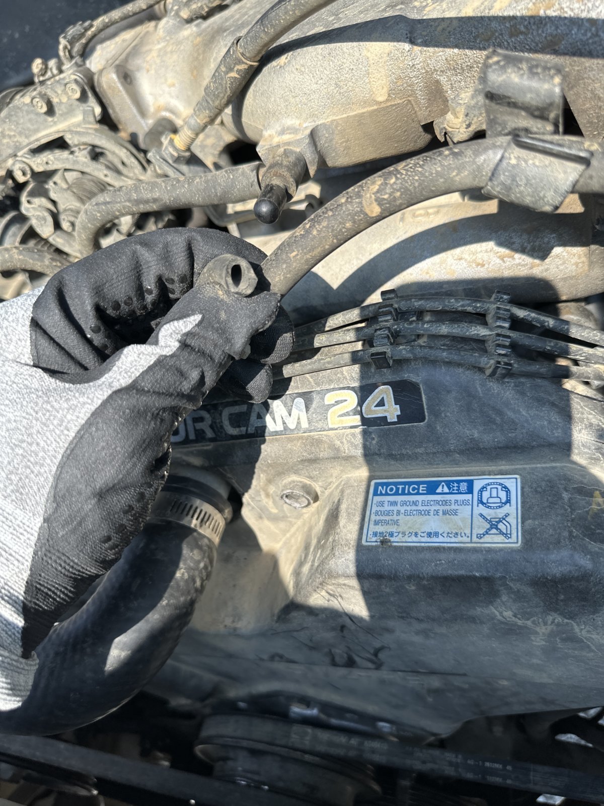

    Wait why is this vacuum line just marooned out here?

    Did you look up a vacuum line diagram and seeeee?

    that definitely goes somewhere

    or look up and see the vacuum diagram on the hood

    I looked but couldn’t tell which one it was. It looks like it’s coming from the power steering pump?

    I have two vacuum lines off the PS pump, one of which does go to that plugged port on the plenum

    possible, early tacomas used vacuum on PS pump to idle up under pump load lol

    The diagram under the hood doesn’t even show any lines in front of the timing cover. Weird.

    Earlier 95-97 truck have a "controlled vacuum leak" to idle the truck up when turning the wheel
    I think 98 and up have a sensor and use the iacv

    they usually only show emissions related vacuum lines (which is like 95 percent of them)

    You should post up like 4-5 pics of the whole engine bay from different angles, or a video like on ur misfire thread going real slow pointing at everything from different angles. Might be able to catch something you've missed that way.
