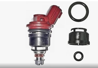

    I had a Nissan dealer tech run up a bunch of hours only to tell me I needed to spend $4,800 for a new engine on a 4th gen Maxima when it was only from leaking side feed injector o-rings that were causing uncontrollable flooding. I had it towed home and fixed it in my driveway for $19 in parts.
    Ozark_RegCab likes this.
