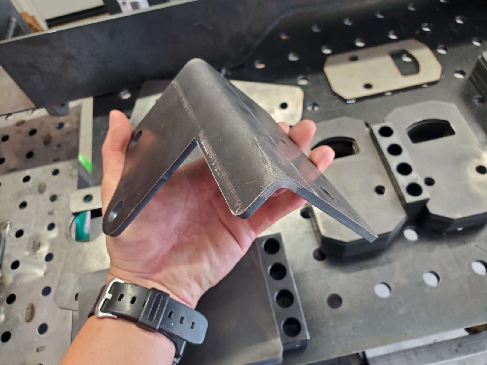

    I don't have the size I want and won't for a good minute but I'm thinking after I upgrade my welding area, I'll look into making my own brake for 30 tons or so.
    Something between 24" to 30".
    The one thing that escapes me is wondering why out of the many DIY or premade setups, none of them are made in a way to accept American tooling.

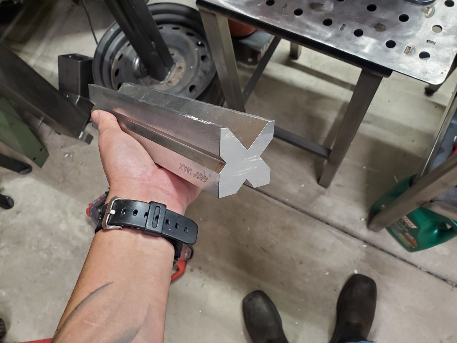

    It would be easy to create a clamp bar for the 1/2" tang American punches use. And for most of your work you can use a 4 way bottom die.

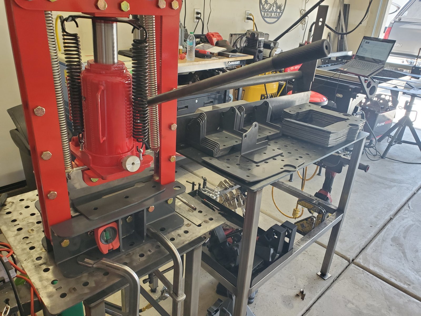

    Back to your brake question though, I do have a miniature one utilizing a 30 degree punch and 4 way bottom die. And in case you forget that your opening must be 8 times larger than your material width, mine is labeled :laughing:
    I do have an air over hydraulic jack on it though making quick work of my bends. For shallow stuff, I'll pump it manually.
    And even though Fusion does the work for me to flat pattern my 3D modeled flanges, knowing the basics that press operators must know is just good knowledge to have.
    I do have the heavy duty, finger brake kit from Swag, but it's only 19" wide and suffers badly from that wide die opening like you mentioned.
    Here's the small 10" setup at work -
    https://youtu.be/aCBkTi2Utg8?si=A6caqxFO9mWj_DpB

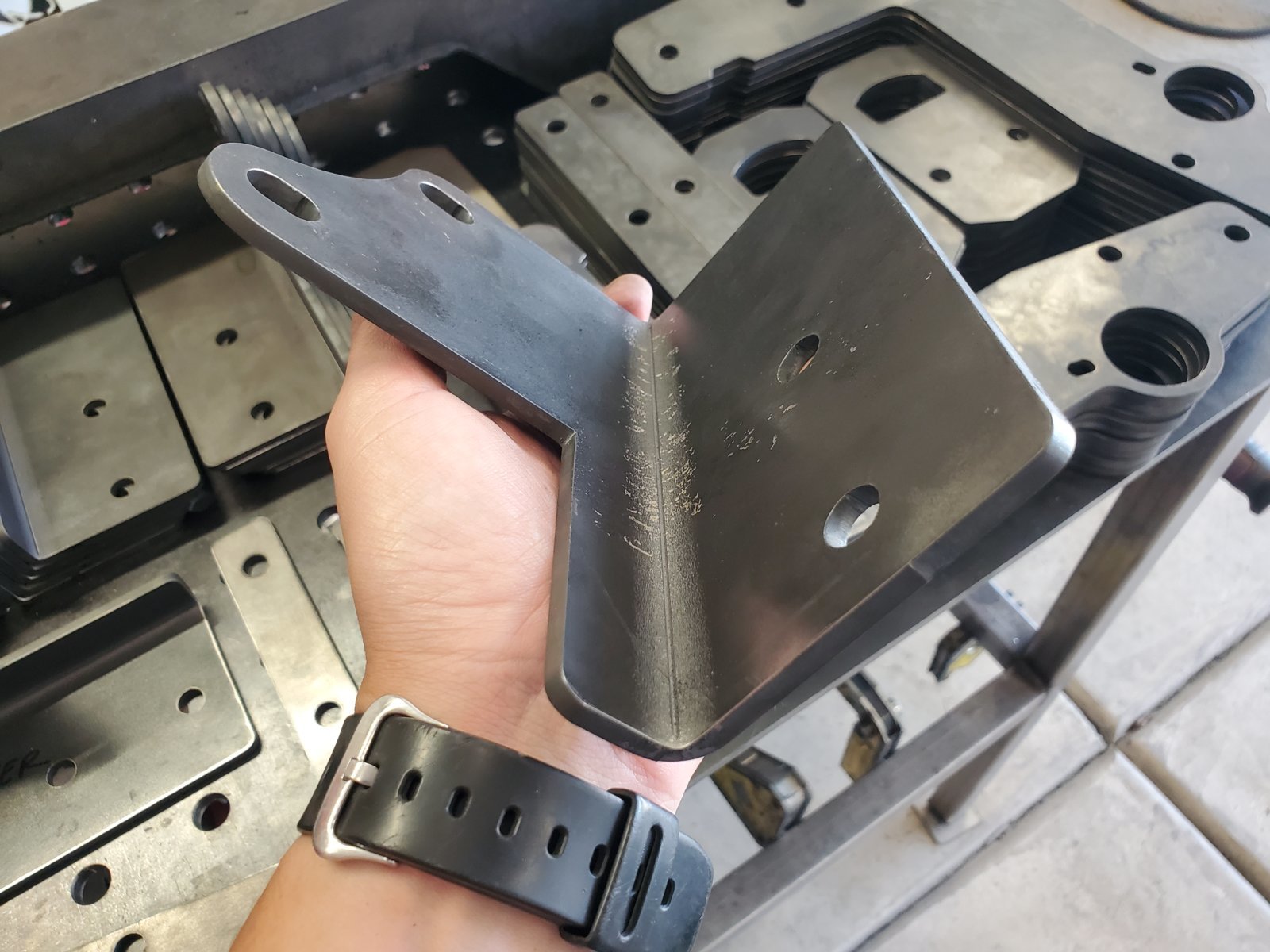

    And here is the result of 3/16" bent to a 90.
    No distortion at all and that leg is about 1" long.
    I can make it as short as 0.75" long and it'll still give me my bend.

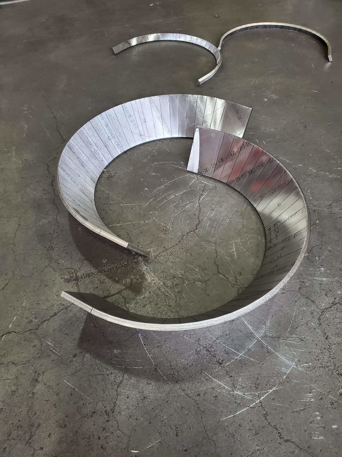

    These guys are the real G's; that's 0.75" thick inconel
