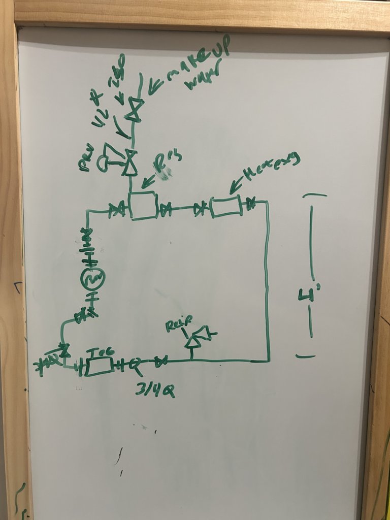

    I mean if i built it, it be like this. Probably gunna use like 1 1/2” wall insulation too because that water had to be a few hundred degrees.

    Its the company truck
    Yes thats my sons white board. Gotta teach him P&IDs eventually :luvya:

    Their P&ID calls out a radiator but doesn’t give how much BTU rejection capacity is needed. Also calls out a water revisor too. Its also a close loop system so you would need a expansion tank to maintain proper pressure in the system because its staying make 10psi.
    Is it glycol compatible too? because you are gunna need like 42% glycol to stop from freezing down to -10°f

    Yeah i would get more info. Because its basically a boiler system, and from all my experience installing hydronic systems you gotta know way more info then they are providing.
    Your home water heater system has a more complex P&ID then what they had
