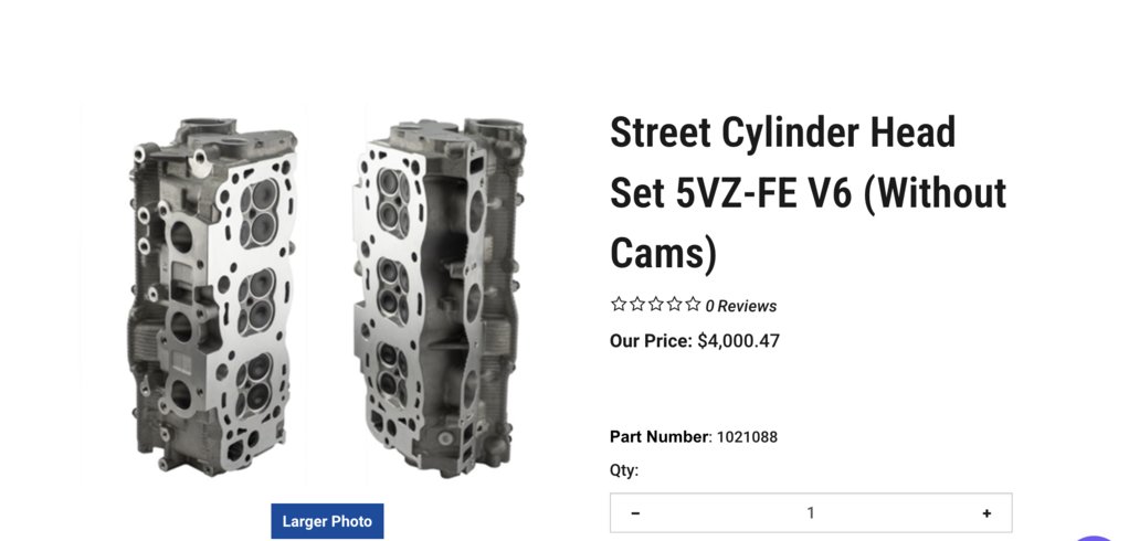

    Latest update.. do I cut my losses or try to source new heads

    Also why is LC engineering so ridiculously expensive? This is over twice the price of the other ones I found..

    It's less Tacoma and more mod
    Those are built heads, they're not just stock replacements. Also LCE is just expensive haha
