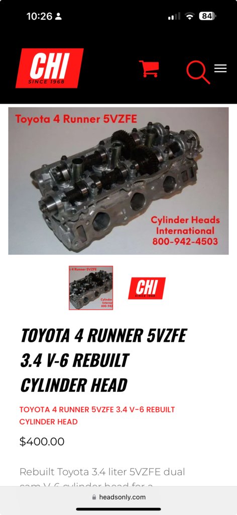

    I posted on the Toyotas of Arkansas group asking for heads
  6. Aug 28, 2024 at 8:23 AM
    Ozark_RegCab
    Ozark_RegCab Well-Known Member
    Jan 31, 2021
    #354648
    6,300
    Nick
    Northwest Arkansas
    1996 Tacoma SR5 4x4 5 speed
    Sliders, lift, 275/70/17
    They also have heads for 850 a piece, but it said “custom rebuilds only.” They also wanted the cores sent to them before they even start. I can’t imagine how long that would all take when you add this mechanic to the equation.

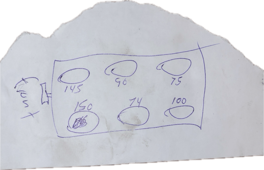

    these were the compression numbers
  8. Aug 28, 2024 at 8:26 AM
    Wulf
    Jan 30, 2015
    #147523
    62,510
    rock raisin
    if you take the average its... yea that's rough

    Also why is this place so cheap?

    You’d think it would still start up and run though, enough to limp it home at least.

    I spent ~3k replacing heads, and the heads were only 1400.
    Didnt have to do all that I did, but its really the best time to do a lot of it.

    That's what my place does em for roughly. They probably want your cores or theres X amt more plus shipping turnaround for both heads

    I had called them when I was looking, they were in a head shortage at the time (same tho)
