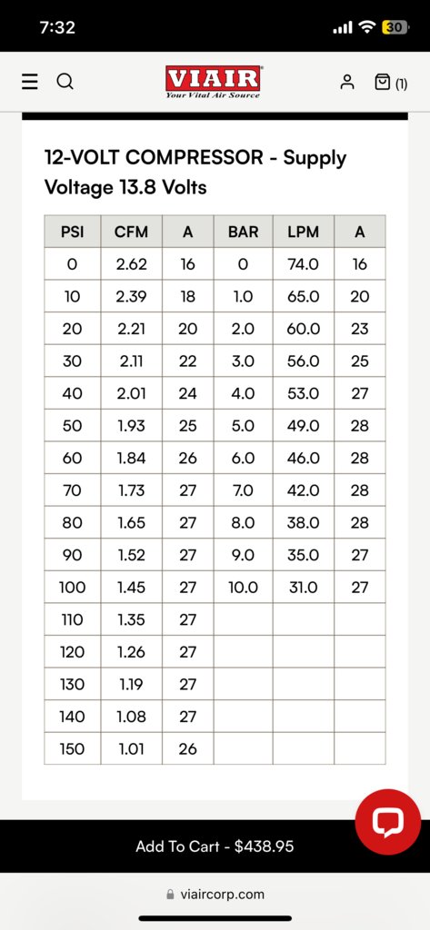

    It'll be way less than 100ft, what about connecting the battery's? Anything special?
    think that compressor was right at 30A

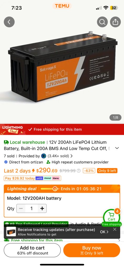

    Also, fckn Temu, shouldn't have looked

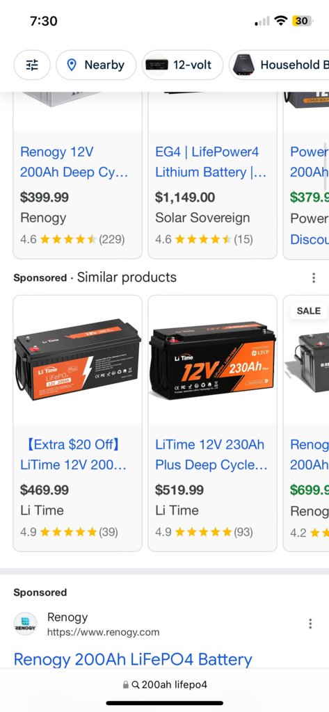

    Without knowing better, how much does a battery like that run (outside of Temu and Aliexpress)

    Dealing with a motor load like that you will need to upsize to 125% of motor full load amperage.

    I'm convinced they're all the same with different stickers

    Size the wire for 35A and call it good. Should be 8awg.
