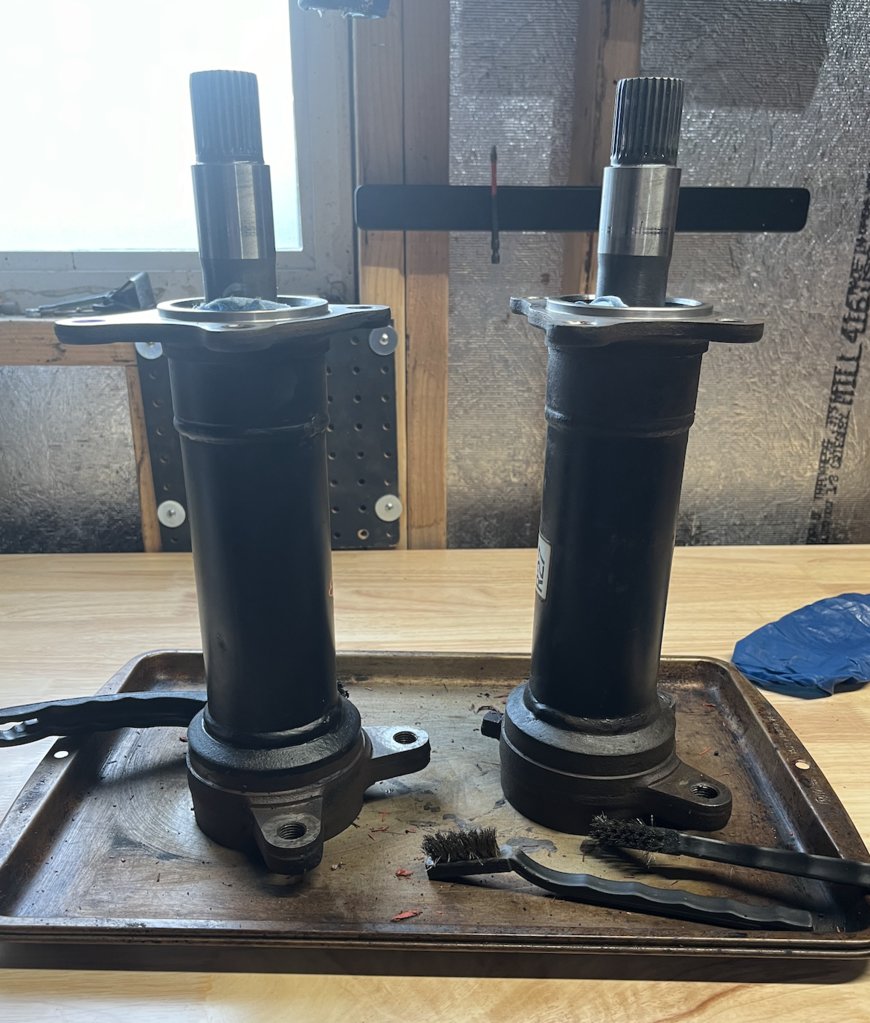

    @Speedytech7 newbie question from a newbie at drivetrain work: What sealant/gasket maker did you use when attaching the output shaft to your front diff?
  19. Sep 10, 2024 at 7:15 PM
    Speedytech7
    Feb 20, 2014
    #123587
    57,890
    FCQM+VG Cheney, Washington
    It's less Tacoma and more mod
    Toyota 1281, Toyota 103 would likely do fine too. But they recommend 1281 for transmissions and transaxles
    CS_AR likes this.
