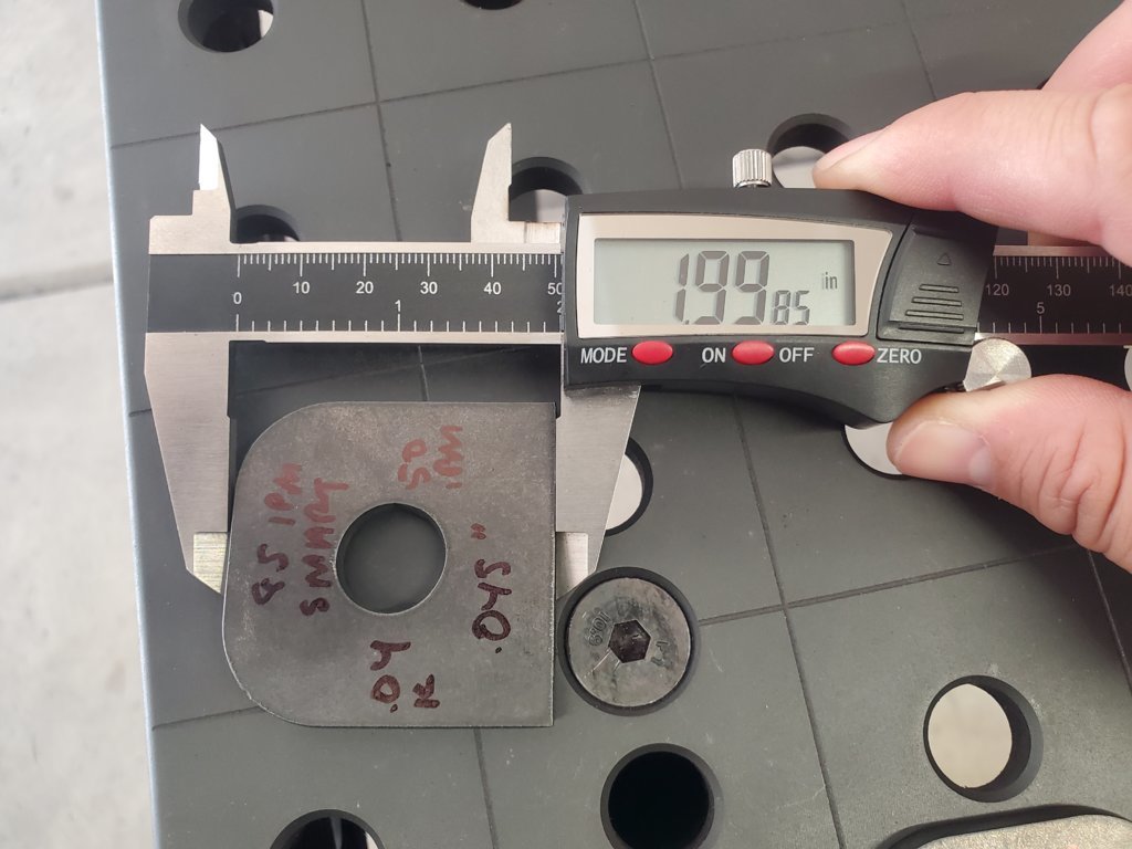

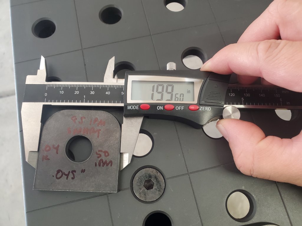

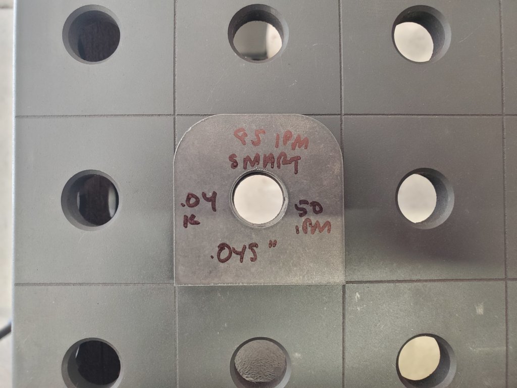

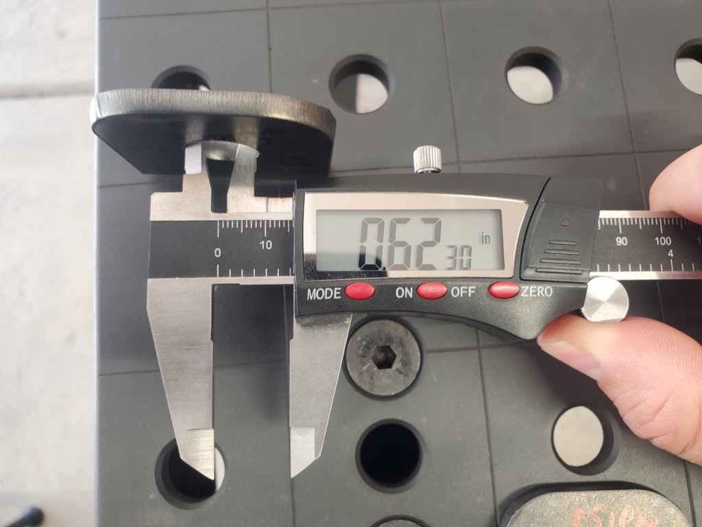

    Here's my second test cut with my new Hypertherm - the test piece on CAD is 2" x 2" with a 0.625" circle in the middle which corresponds with the pattern on my fab table
    The first test cut was to measure my kerf width as accurately as I could, which came out to about 0.040" which resulted in a part cut within 2-3 thousandths of an inch
    The part had received absolutely no clean up since it cut so well. My only gripe is the minor beveling I got on the top edge but I'm blaming that more on the torch mount so I undid everything and need to mount it again and ensure squareness
    I think if I bump up my kerf width to 0.041 or 0.042 that I'll be right on the money in terms of accuracy
    The biggest difference from the old setup and new setup though is, cut speeds are much faster, and pierce delay is significantly less, while still providing better cut quality
    02hilux and Tour991[QUOTED] like this.
