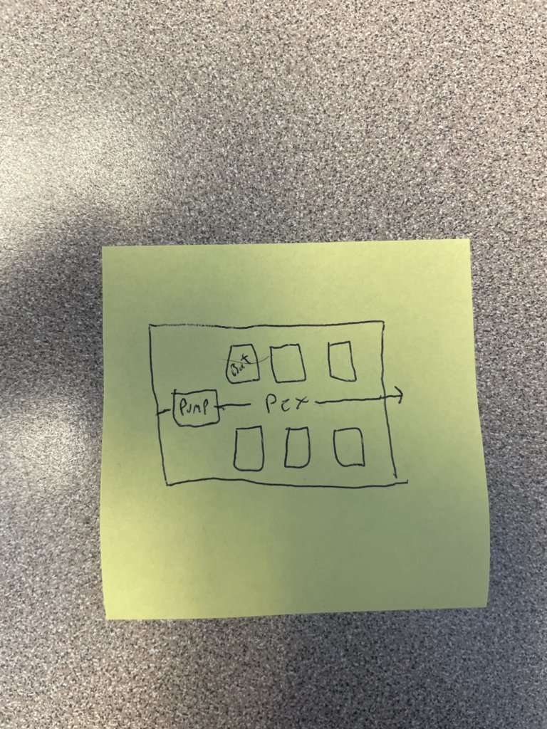

    Does pex hold its shape when it goes hot?
    thinking about using it instead of just normal hose stuff to keep batteries warm
    likes 3 foot piece from pump to wall
    my drawing is good

    How hot we talking. Its used is domestic hot water all them time which is 120°. But its only rated to 200°

    150-160° max

    You know how much psi is on the line? It will probably be fine, pex does like to expand and contract when getting hot and cold. But if you add a few pipe clamps it will probably be fine.
    is there a reason you dont want to just use a small piece of copper pipe?

    Then Yeah that temp and psi will be fine. Pex is rated at 200° but its temp rating drops as the pressure goes up. Like its 180° at 100psi. But you’re pretty low pressure
