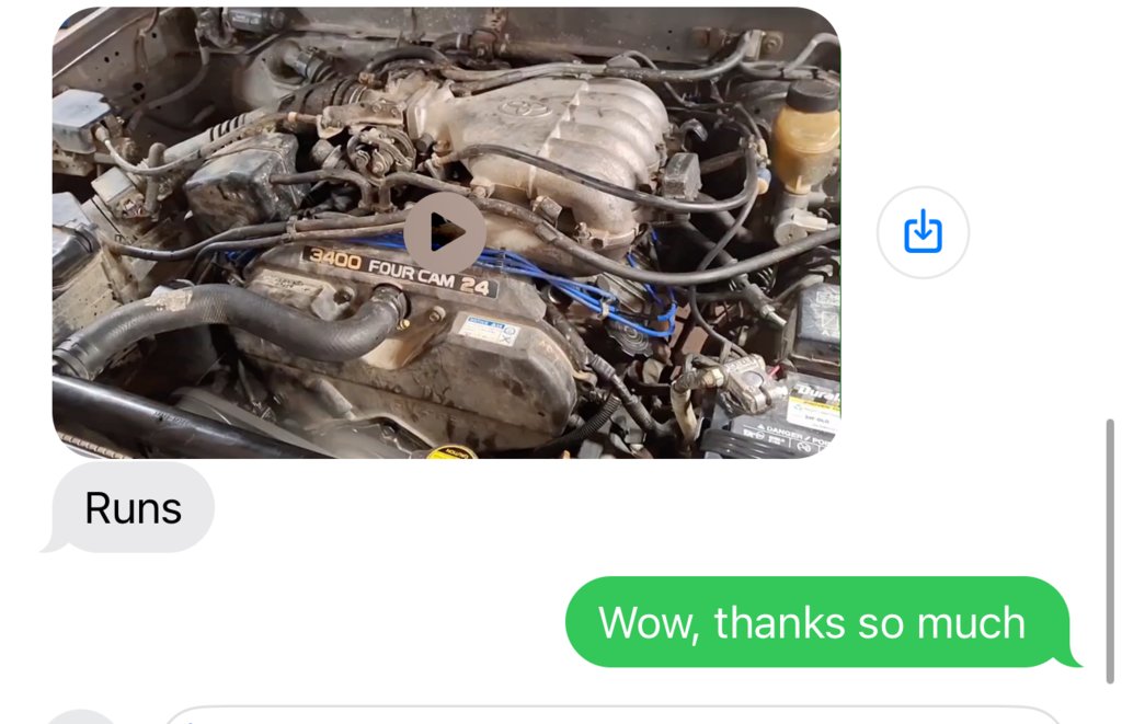

    The gamble paid off

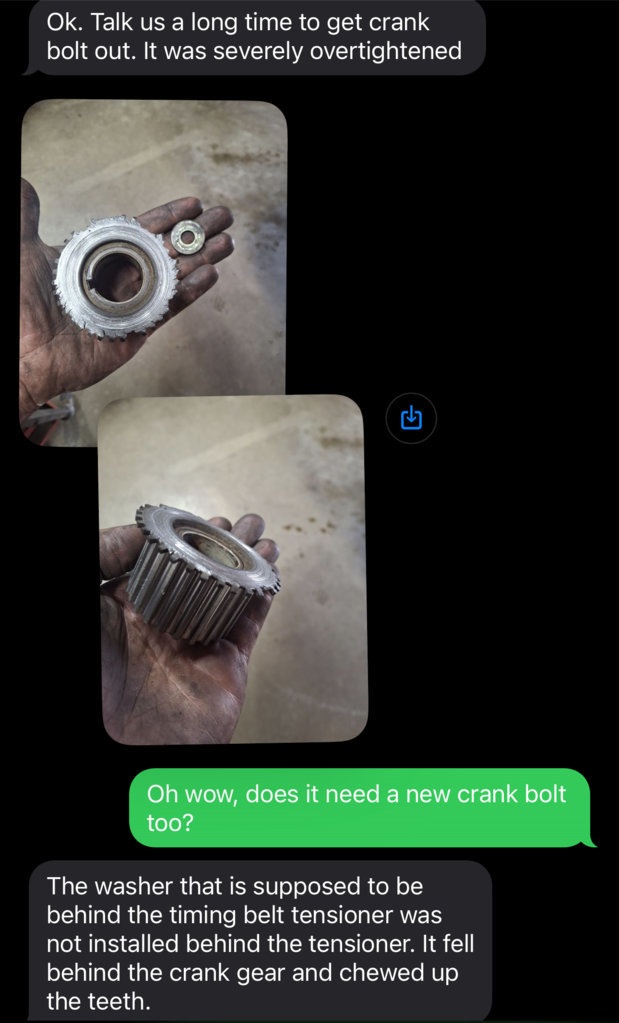

    Im curious what the old crank gear looked like if he sent you any pictures
    unstpible and time623[QUOTED] like this.

    This other mechanic is worse than I thought. I wouldn’t trust him to do an oil change. How the hell this guy has 4.9 stars I have no idea.

    Aren't you sitting here trying to figure out how the washer was behind the crank gear but not installed???
