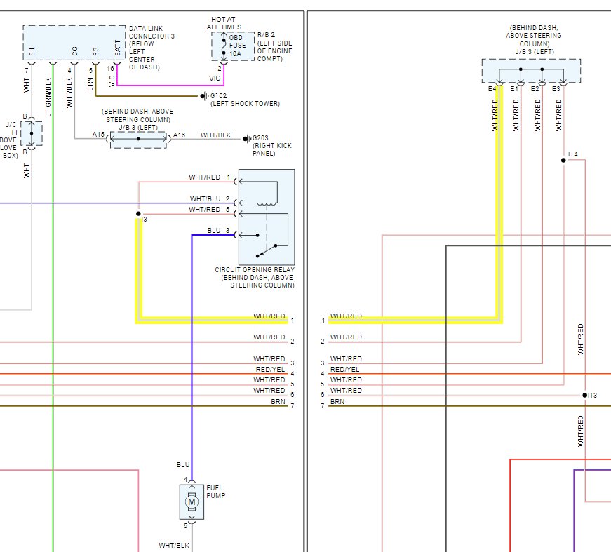

    @m3bassman, the circuit opening relay is hanging off the dashbar up above the steering column to the drivers side. Interrupt the white/red wire with a regular spst switch before it branches off to the two pins on the circuit opening relay and it'll kill the fuel pump power and the 12v relay coil pwr to the fuel pump pin on the ECU, engine won't start.

    @m3bassman Here is a full engine wiring diagram for a 2001 5VZ taco incase you want to get fancier or maybe you'll find something simpler.

    You could interrupt that if you wanted I suppose. That blue runs down and actually junctions right under the drivers seat before going under the cab to the back. Plenty of ways to skin a cat I suppose here. Shame toyota doesn't actually use a dedicated fuel pump fuse, the Circuit Opening Relay is fed off the main EFI circuit. No matter what since you're interrupting 12v anywhere in the circuit use a 20a capable switch.
