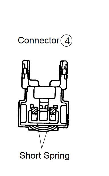

    Look again this looks like it would have that part.

    I tried seeing if i can fit that part in there but there is no way of closing the door after. I can try agian though.

    cam from this section of FSM.

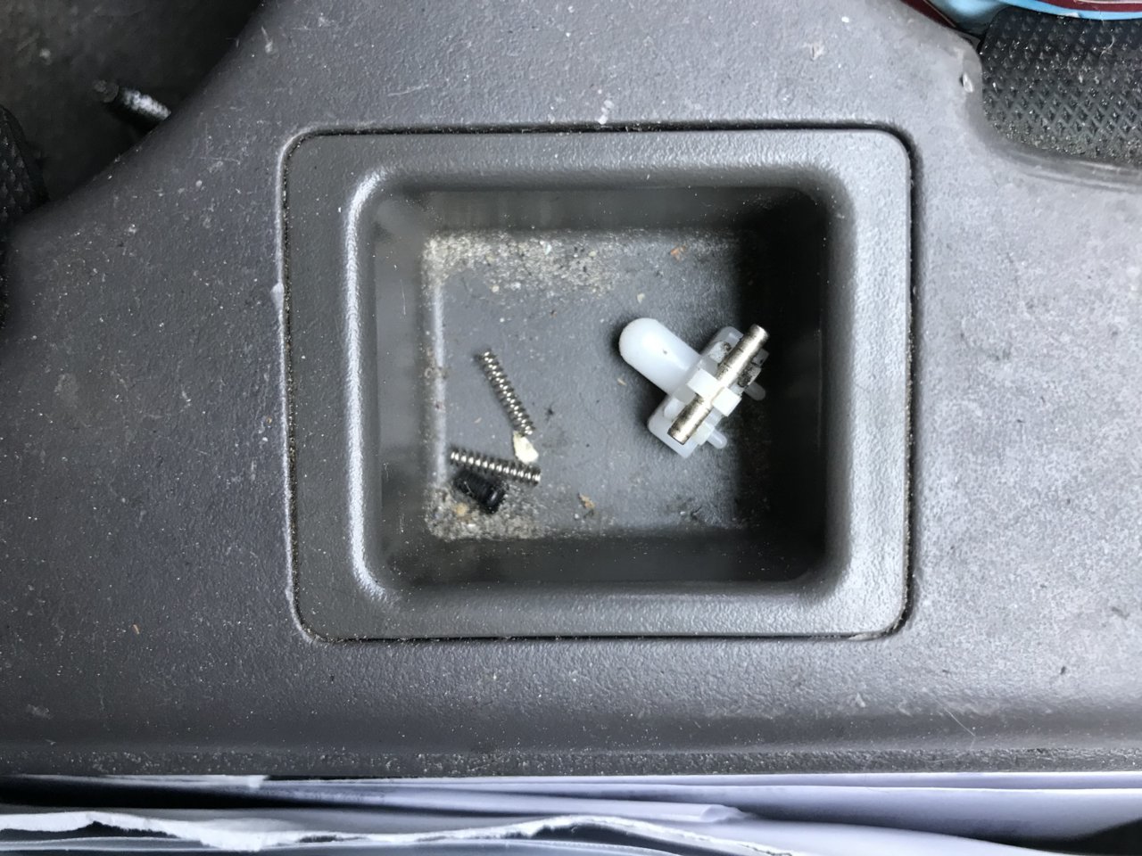

  15. Jul 4, 2018 at 8:41 PM

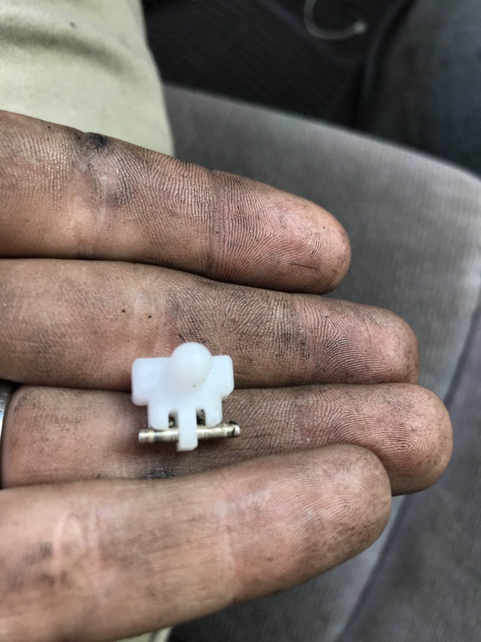

    Hey @BartMaster1234 have you ever seen this part while working on your steering wheel

    Looks like something out of the backing plate for the turn signal stalks. Just a shot in the dark.
    My best guess is that it’s a retaining pin from a connector.

    Tell you what, take some clear pictures of it next to a penny and I’ll post it on reddit and see if they can find out what it is. @Sperrunner

    Those two small springs you see go on the back of that part I believe. And under that metal pin is two small sprins as well
