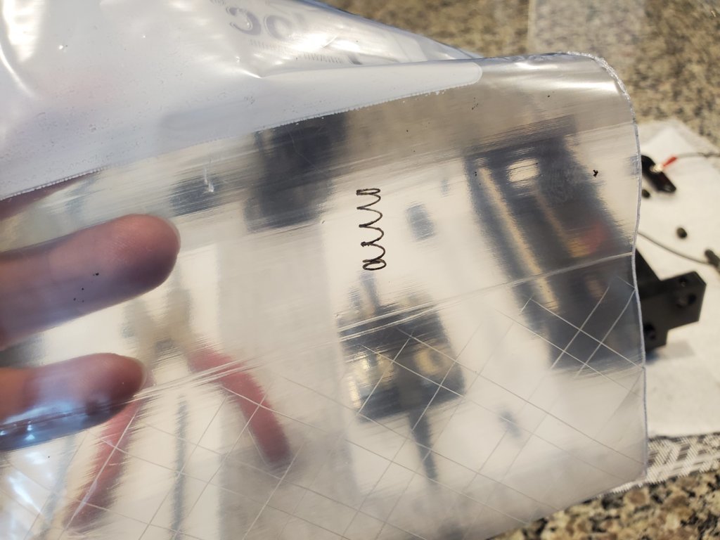

    Use a baggie for catching the spring in your IHS.
    This is something I picked up from rebuilding manual hubs.
    Funny when you read about people losing their IHS spring because they took it apart only for the spring to fly into oblivion :rofl:

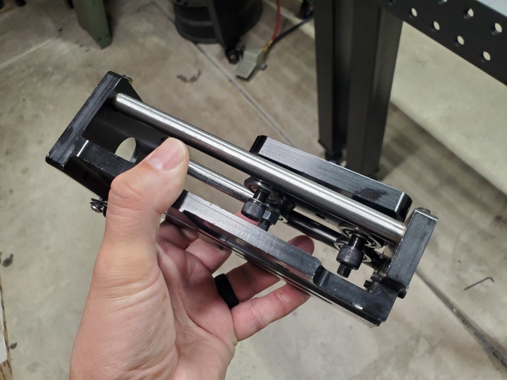

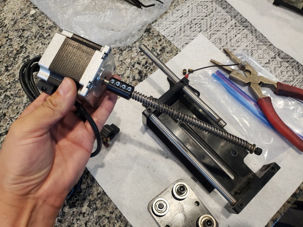

    Need to cut the small bolts here to retrieve a back up lead screw and motor; socket cap screws got stripped trying to remove the coupler so I pulled out the whole lead screw and motor assembly
    I felt like Predator removing the head of his prey with a spine attached

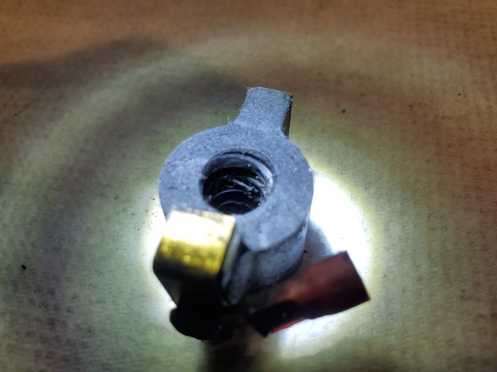

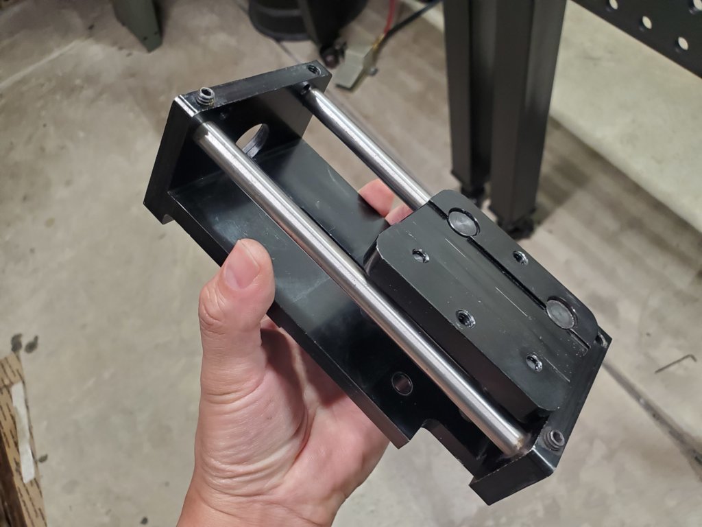

    I'd love to come up with a replacement Z axis assembly running linear rails instead of those eccentric bearings
    Not to mention use something else for coupling with the lead screw since it uses a cheap plastic threaded setup that strips easily
    Guess a sort of limit switch could be used in lieu of the "spring" setup for IHS? Then how does one figure out springback from there?

    Be pretty easy to put that on a carrier with sulfer bronze bushings... but less serviceable too. Doubt it would help the accuracy in any meaningful way considering it's just torch height rail, not a Z axis that takes load like a mill would have.

    I only learned it myself cause a spring did fly out on me on the first set
    Luckily I found it since it was on my hard floor in the dining room
    In a shop setting? That's the forever yeet bro
