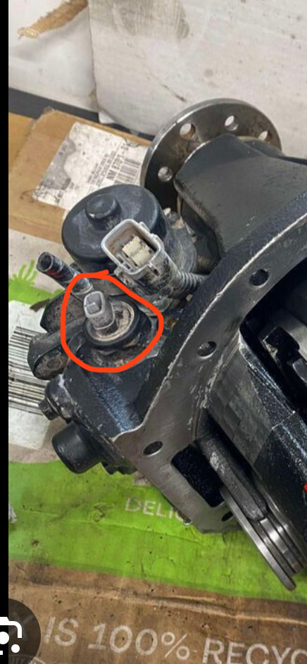

    I guess it just makes a connections somehow? No wires, which is nice

    I mean it is supposed to plug into a wire harness if that's what you mean? But all it is is a little ball on a spring that when pushed in indicates it's connected. Kinda like a door switch.

    Perfect, probably should order one

    If you have an autozone, Napa, or really any other parts store just get a reverse switch for a 96 tacoma 4cyl or v6 with a manual trans. They're usually like $20

    Even better
