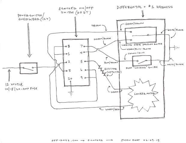

    Anyone k ow what pins I need to see if there's 12v to or whatever
  12. Oct 11, 2024 at 11:59 AM
    Tour991
    Tour991 Supplier of used parts
    Nov 24, 2011
    #67616
    10,719
    James
    South Reno/Tahoe
    97 2/4wd, 2014 DCLB 4x4, 99 T4R Limited (sold) 2024 4runner TRD Pro
    are you doing a stand alone harness for it? this is the diagram I used to make a harness and just ordered a generic switch on Amazon. this may or may not help.
  13. Oct 11, 2024 at 12:03 PM
    JKO1998
    JKO1998 Well-Known Member
    Jun 2, 2015
    #156578
    52,887
    Utah
    I had a dude on insta gram build me a harness, might be the problem
