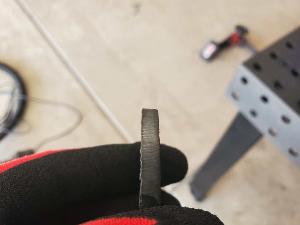

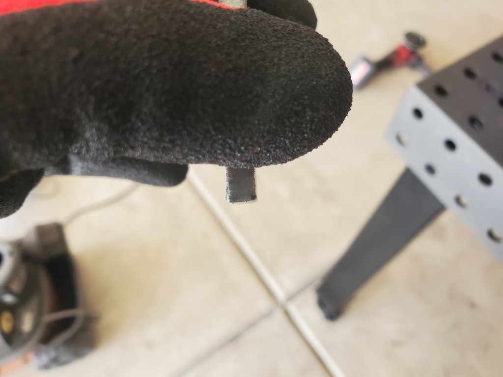

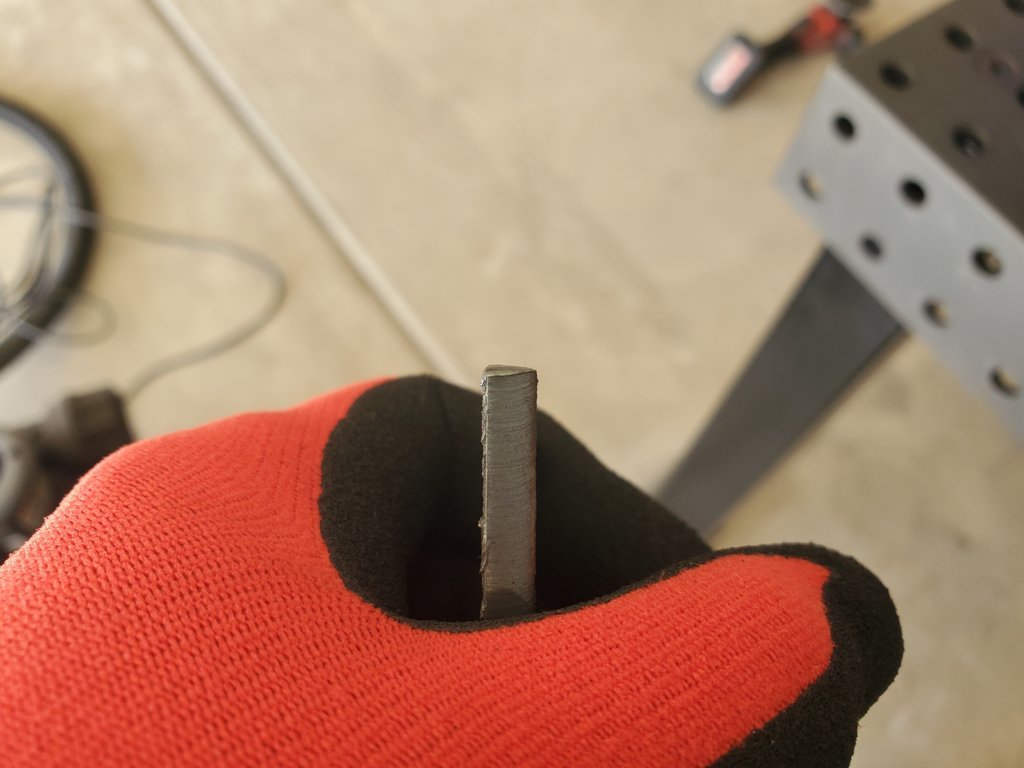

    what o-rings lol... like legit the torch cable itself?
  2. Oct 11, 2024 at 1:42 PM
    Kwikvette
    Feb 27, 2019
    #284735
    80,690
    Fresno County
    4 run, 2 don't
    The connecting plug from torch to machine has an o-ring. Many of them do since air goes through the plasma cutter and out through the torch.
    The other one is on the torch head, and is readily visible when you pull your retaining cap.
    I thought nothing of it because they look shiny (pre-lubed from the factory) not to mention all of it is less than 2 months old. I even checked them out and they had that residue feeling on them meaning they were "lubed".
    Well, spinning them around a bit while adding some lube provided the above results.
    Hoping this weekend any parts cut out experience the same results (or better).
