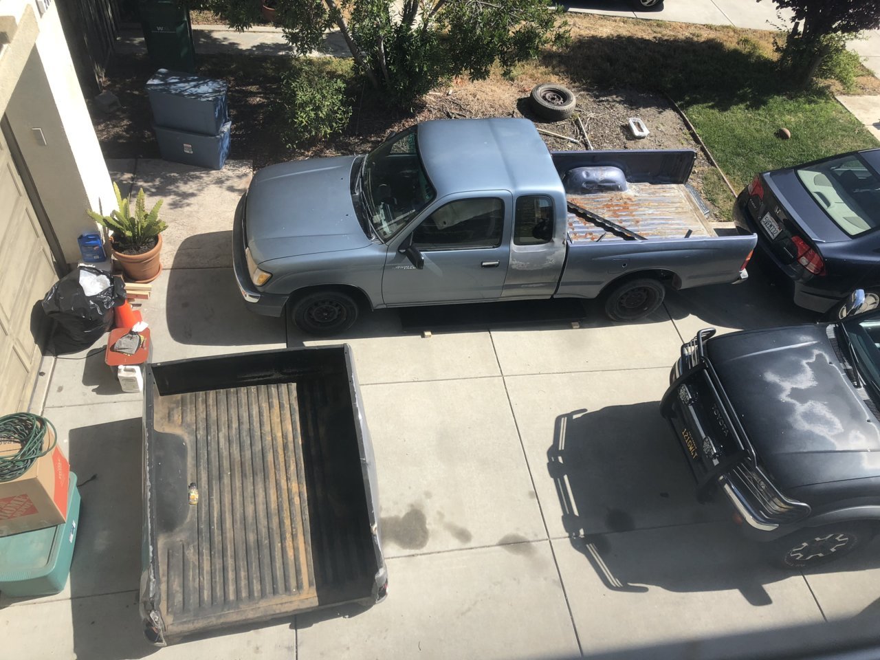

    I didn’t know the bedsides were removable on the first gens ? I need my passenger rear side replaced badly

    Yeah it just requires drilling out all the welds and getting new bed sides welded on. Unless you get glass then you bolt that on

    Oh they’re removable not. At all.
    It’s all spot welded and pinch welded. It’s going to be very very difficult to remove the pinchwelds, re-weld the bedsides, and use do some strategic body work to make it look factory again.
    They’re bolt-on I believe on your 2016.

    You'd need about 50 bolts to put one bedside back. There are a million spot welds holding each bedside to the bed.
    Plus it would look pretty fugly to have that many bolts sticking out.

    There’s about three cracks I can see. Some body filler will fix the little cracks and chips otherwise.
    For these I’m planning on doing the layers of the fiberglass cloth and the resin.
