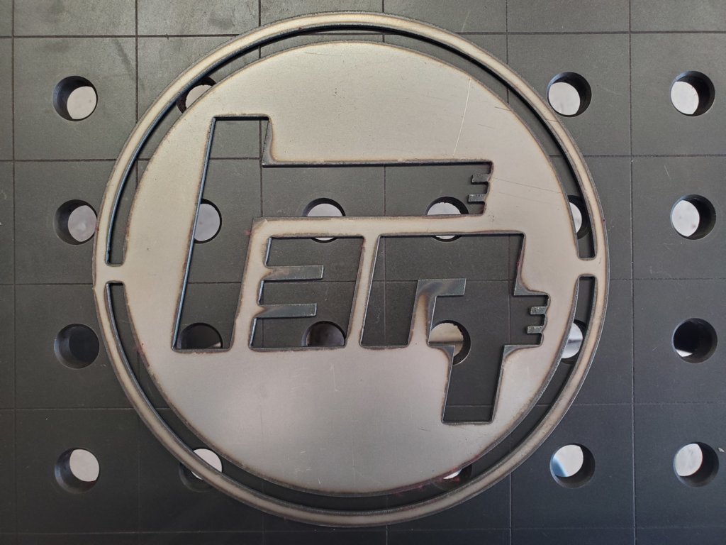

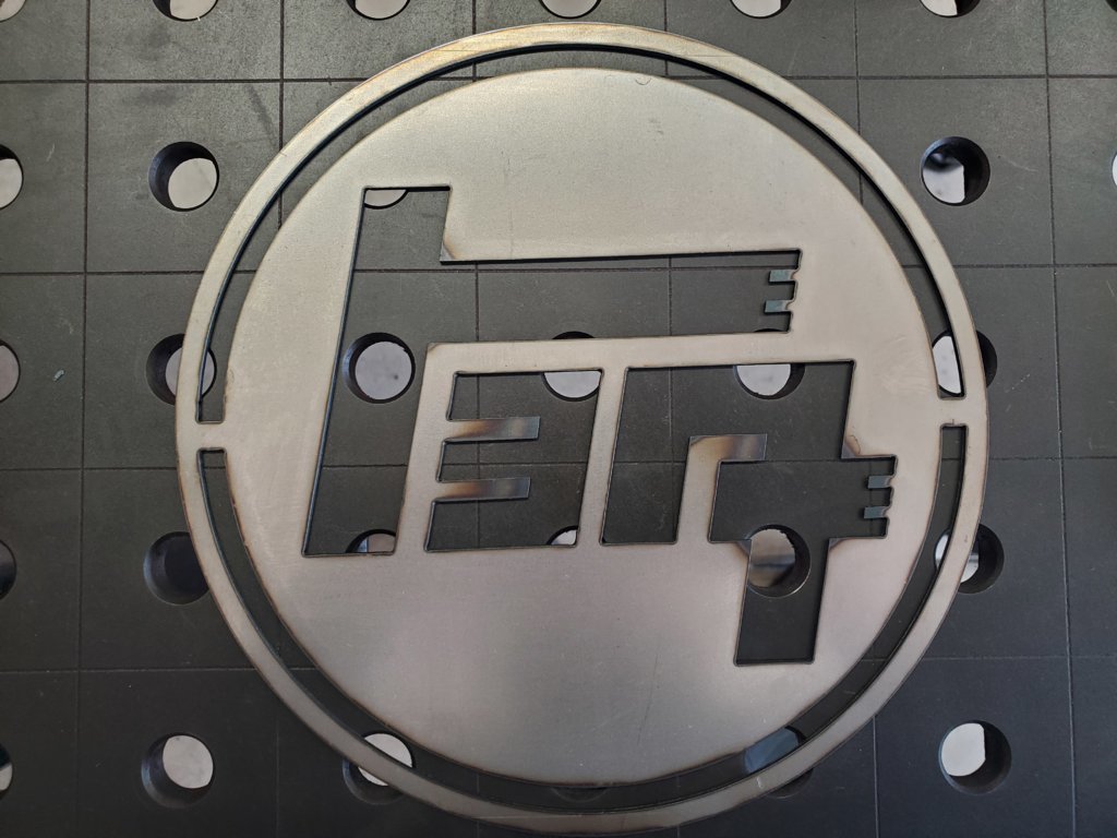

    @0xDEADBEEF
    Although I might be tempted to make them sooner than later :rofl:
    Mainly because I've been really digging these finecut consumables I got.
    Here's a TEQ sign cut out with regular consumables -
    And the same sign in the same size with finecut consumables -
    The heat build up is far less which is evident by the lack of discoloration along the cut path. Not only that, the top one got slightly warped whereas the bottom one is still flat.

    Oh nice. The fine cut consumables really put the heat where you want it and nowhere else.

    Does that mean you can run it faster at higher amperage?

    Oddly enough, the book settings show as the same speed being used for both regular and finecut (within 1ipm)
    Regular consumables - 45 amps, and 249ipm
    Finecut consumables - 45 amps, and 250ipm as well as a 40 amp, 150ipm slow cut setting
    I used the 150ipm setting but opted for 32 amps as my first test cut. I need to run it at 40 amp and 150ipm to see if it's at all any different.

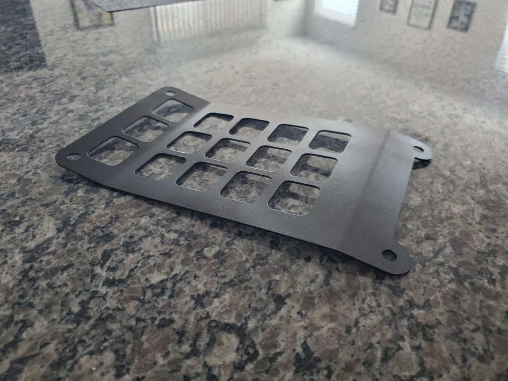

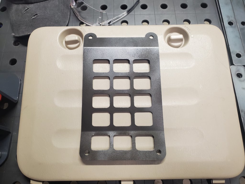

    Yep I see the bend now.
    I just pulled off my panel and will go about measuring it.
    Only thing I'm "bad" at is deciding what formatting to use for the molle panel.
    With aftermarket companies, they all follow the standard fitment loosely...here's my last attempt at a molle panel for a 3rd Gen owner.

    It definitely seems like a pretty loose standard. Are there items that require a specific hole size?

    It's more like, the spacing from left to right. I see variations in just a few items I own.
    Here's that panel, forgot I made an extra one for myself to keep as a "master"
    They're 1.5" wide openings, which is the most common. The spacing is a lot tighter than the one you linked though.
    I'll toy with it and cut a set out as soon as tomorrow just to see if my pouch fits.

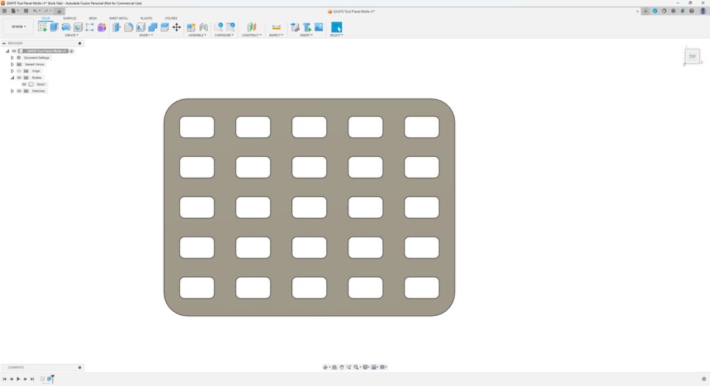

    @0xDEADBEEF
    I've got another pattern I'll try out, but I just mocked up the one you linked.
    I'll deal with the bottom tabs and holes later, this is just to test overall fitment and molle attachment.
    Thinking I'll cut it tomorrow.
