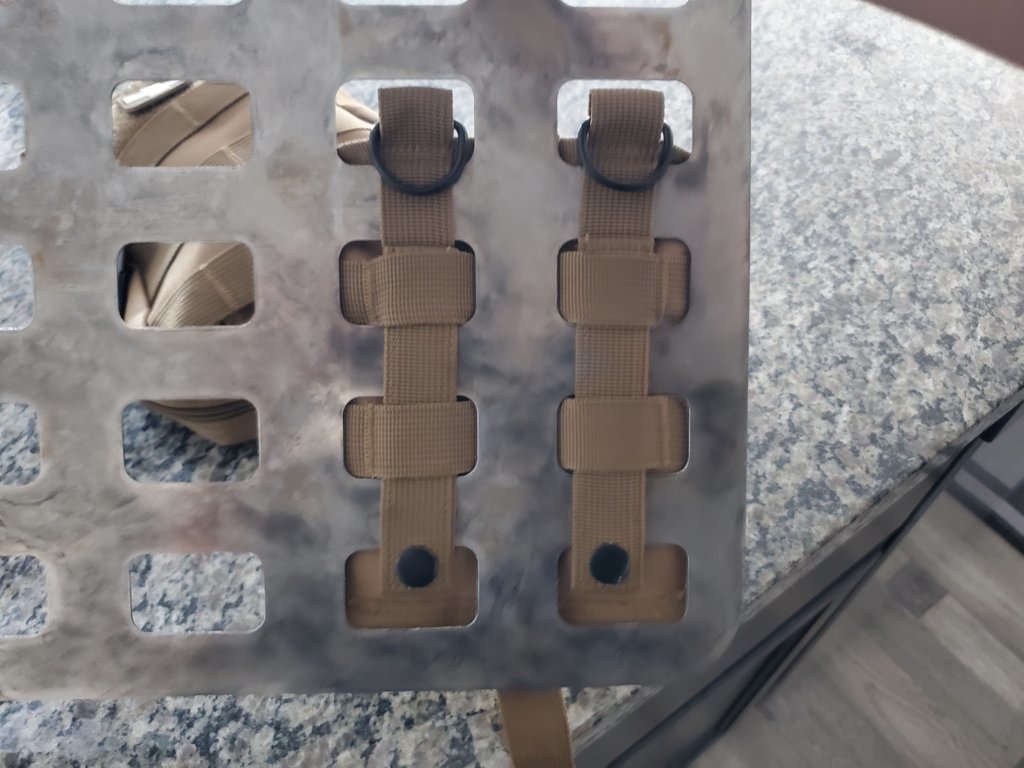

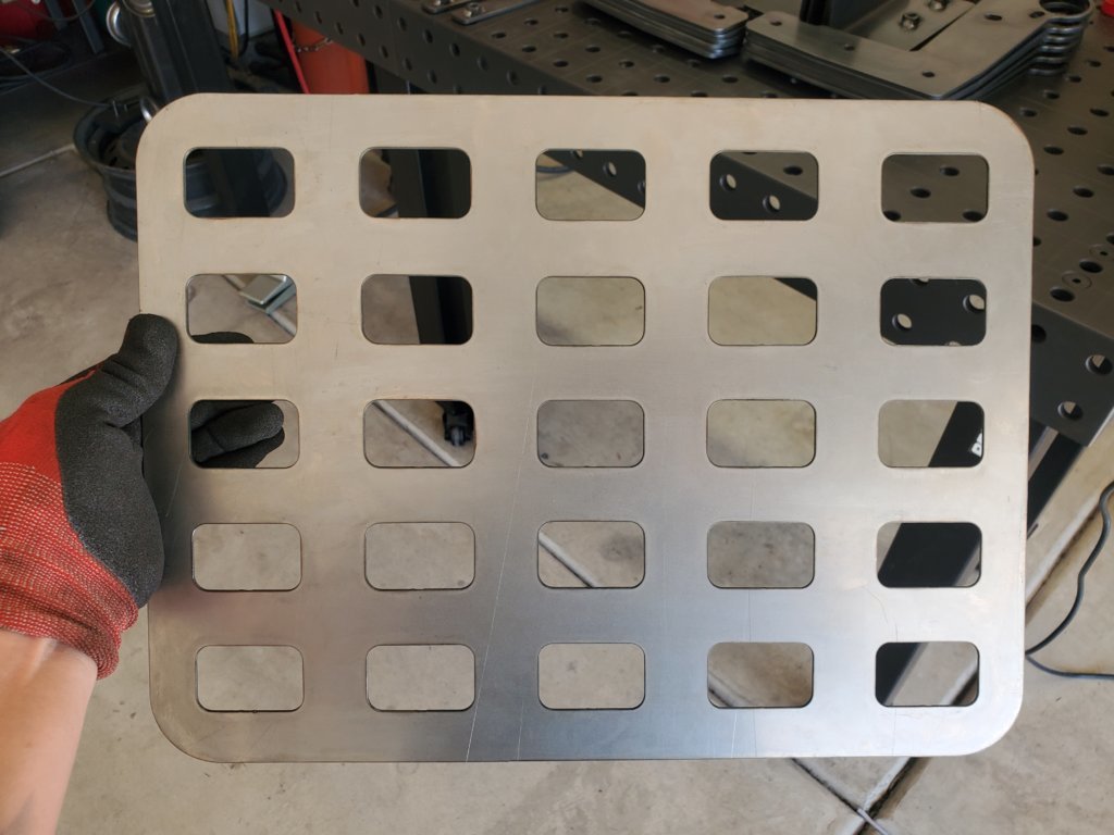

    @0xDEADBEEF
    Just need to paint it black, put a logo on it, include a Punisher sticker and I can call it tactical and charge $199 each before shipping
    No but really, not bad for a first try
    What really keeps it from making it fit are the stupid bottom corners
    The radius isn't exactly "round" so it doesn't fit within the space
    I intended to make it rest and sit within the opening
    Just have to trim the bottom corners a tad, maybe shorten the overall height by 1/32" to 1/16", remove some of the slots to allow for bolting it in place, and adding the bottom tabs

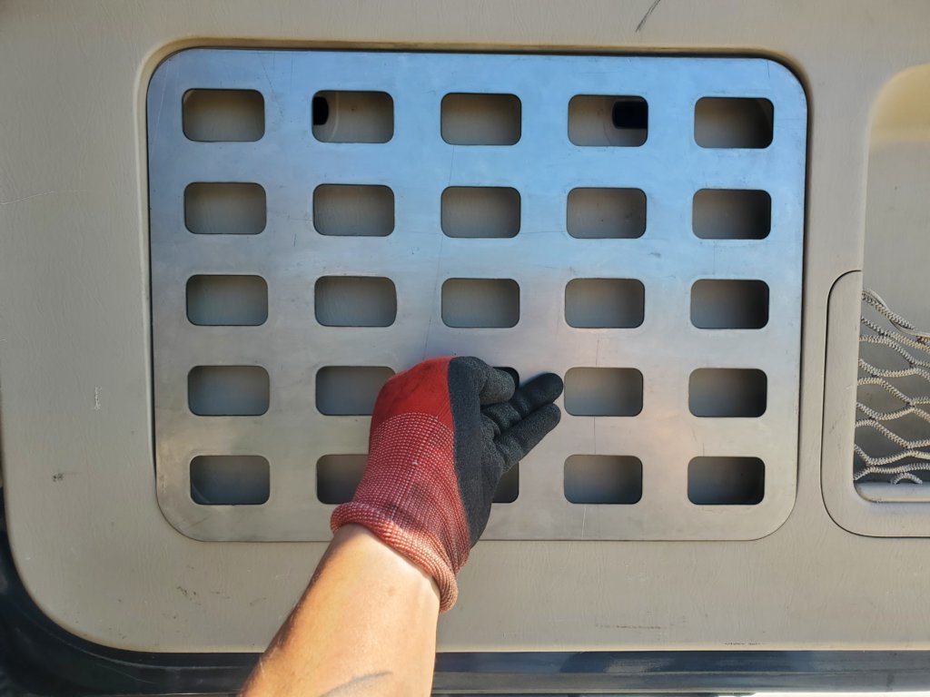

    Which reminds me, let me test out the weave pattern

  6. Nov 4, 2024 at 11:43 AM
    Kwikvette
    Feb 27, 2019
    #284735
    81,415
    Fresno County
    4 run, 2 don't
    Definitely ain't going nowhere but it's close!

    @0xDEADBEEF
    What do you think I should use to latch the top part of the panel though?
    Maybe a J hook or some sort of T at the end?

    It looks like the factory setup uses sort of a T-shaped latch into a slot in the sheet metal of the door.
    First thought would be some snap in nuts to go in the slot (maybe with a spacer to keep them in place: https://www.mcmaster.com/products/threaded-inserts/snap-in-nuts~/ and then a knob with threads or these snazzy cam handles https://www.mcmaster.com/products/knobs/cam-handles~/
    Kwikvette[QUOTED] likes this.
  15. Nov 4, 2024 at 1:08 PM
    0xDEADBEEF
    Mar 2, 2019
    #285037
    19,828
    2000 reg cab 4x4 flatbed MT
    Or, maybe take a carriage bolt, grind it into a T( or maybe some of these https://www.mcmaster.com/products/t-slot-bolts/t-slot-bolts~/ ) , fit that into the slot, and then put it into one of the threaded hole cam handles. Only 2 pieces to deal with at that point.
    https://www.mcmaster.com/products/knobs/cam-handles~/mount-type~threaded-hole-1/
    Or maybe use one of the ones with the built in stud and weld one of these to the bttom to make a tee:
    https://www.mcmaster.com/products/t-slot-bolts/weld-nuts~/
