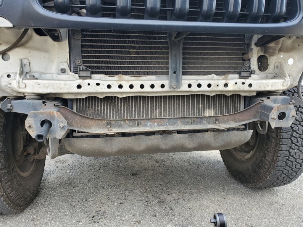

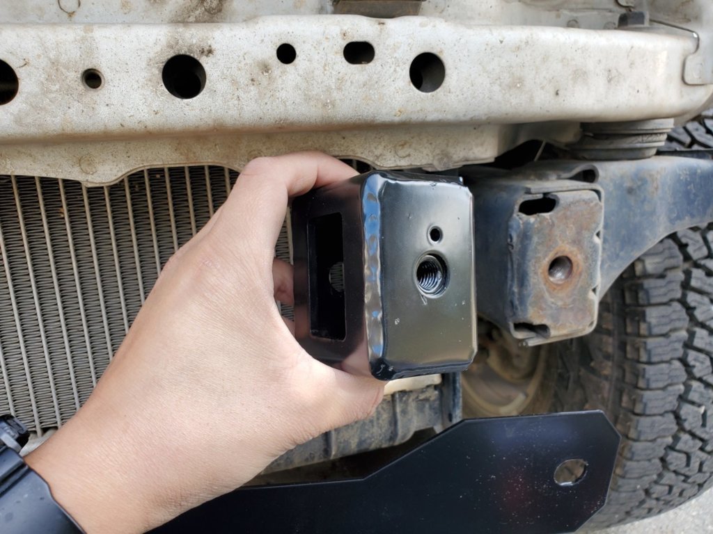

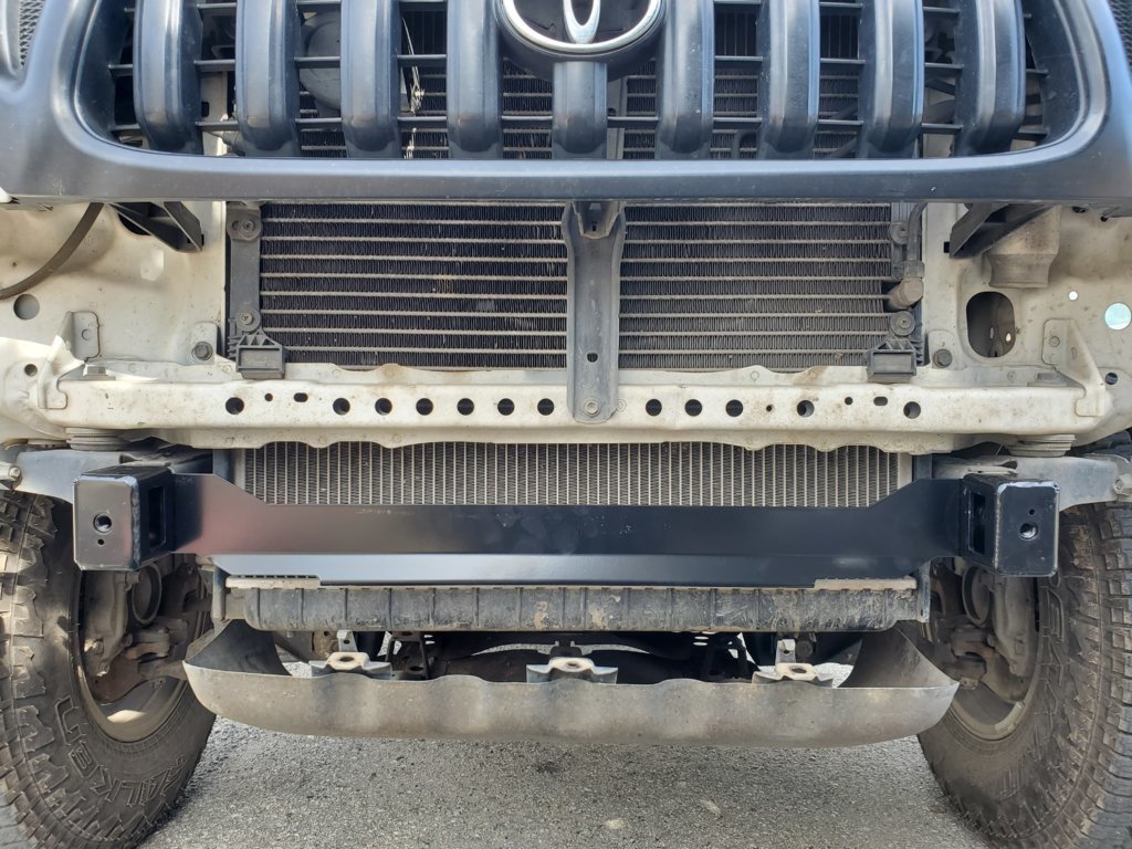

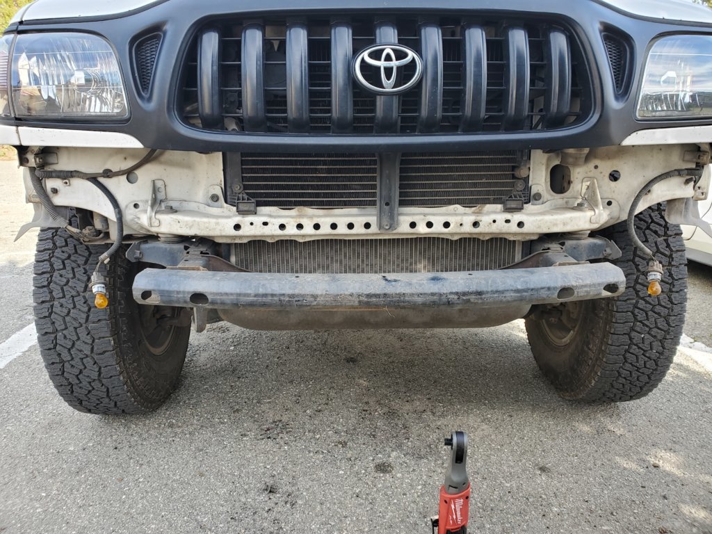

    It's just the frame horns from what I've seen; instructions for one version include chopping the horns off whereas other models just unbolt with that center bar
    Sits right behind that front support I mentioned
    The ARB setup requires bolting onto the frame horns; for those that have to chop them off they just need to weld in some flat stock and ensure they add a bolt to thread onto
    Quick and easy install from what I remember, just fumbling with those capture nuts is all
