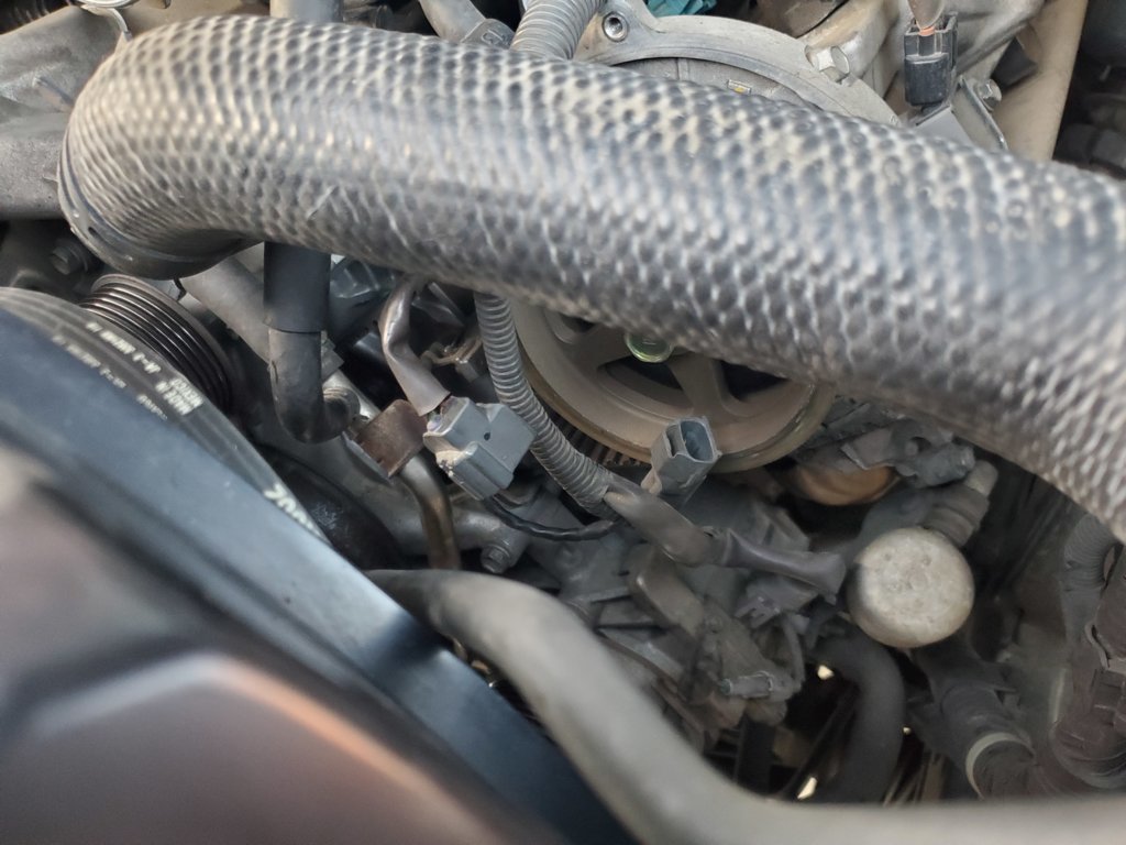

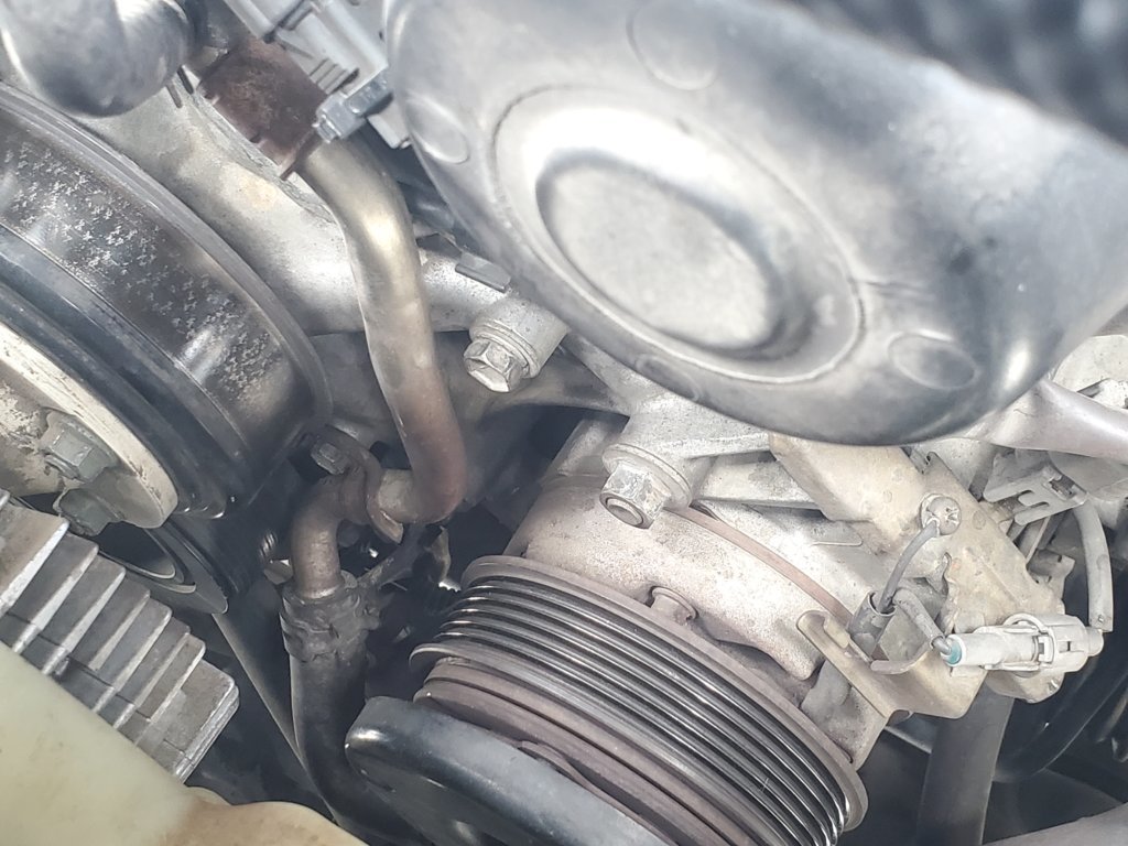

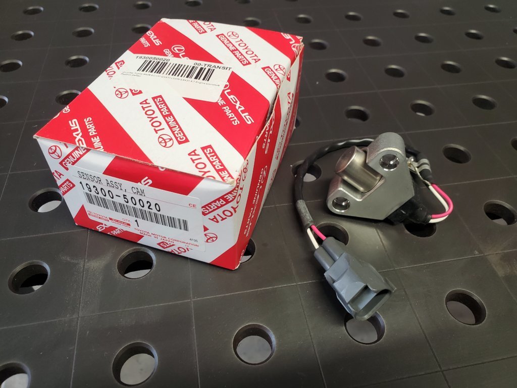

    A stripped bolt can turn an hour job into several
    The damn bracket on the coolant pipe is in a way where it prevents a socket from fully seating, so the nut was already slightly stripped :annoyed:
    Extractor won't grab it, so I'm rethinking before going back at it and yeah I used a small pry bar to try to open up the gap a bit
    Think I'll go at it from underneath
    Speedytech7[OP] likes this.

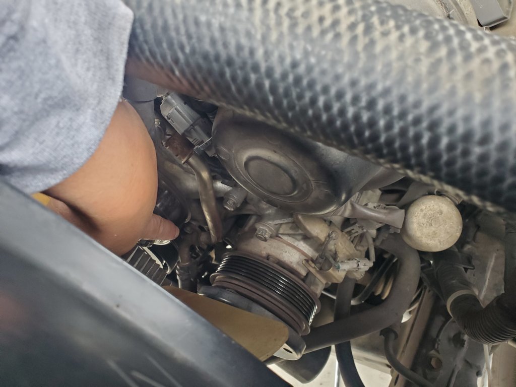

    Going from underneath I still can't get enough bite even pushing it to the bolt.
    What say you @Speedytech7 I hate dealing with stripped, hard to reach, super shallow bolts.
    I'm going to give myself more room and pull the radiator shroud and fan clutch to see if it helps since the bolt is directly behind the center of the fan clutch.
  11. Nov 27, 2024 at 11:55 AM
    Speedytech7
    Feb 20, 2014
    #123587
    58,541
    FCQM+VG Cheney, Washington
    It's less Tacoma and more mod
    I have some smaller sockets that I've bumped against the belt sander to take off the chamferred portion so that they bite on the shallow bolts better
    jubei and Wulf like this.
  12. Nov 27, 2024 at 12:02 PM
    Kwikvette
    Feb 27, 2019
    #284735
    82,827
    Fresno County
    4 run, 2 don't
    I'll try that since my fan clutch nut rounded itself even with the full engagement I had :anonymous:
    Confirmed they're not reverse thread, nope they're just damn nearly siezed on
    Wulf likes this.

  14. Nov 27, 2024 at 12:09 PM
    Kwikvette
    Feb 27, 2019
    #284735
    82,827
    Fresno County
    4 run, 2 don't
    Yeah I'm gonna sacrifice a socket or two in a bit.
    Just need to grab something to eat and not go at it angry; I don't care about having to replace hardware. It's just getting to it in such a tight space.
    This bracket placement is ridiculous
    Job itself is easy, even got the timing cover bolts loosened.
    The pipe and bracket need to be unbolted to pull back the line far enough to get it off the stud the cam shaft position sensor is bolted to.

  16. Nov 27, 2024 at 1:17 PM
    Kwikvette
    Feb 27, 2019
    #284735
    82,827
    Fresno County
    4 run, 2 don't
    Yeah I'm gonna chill for the rest of the day.
    Reached out to my buddy to see if he's got any other tools to grab those bolts. Also, soaked them in penetrating fluid and figured I'll go at it tomorrow after letting them soak for a bit.
    Helps having another vehicle, but it sucks that a simple stripped bolt stops you in your tracks. Sensor arrived early so I wanted to get it swapped right away.

  19. Nov 27, 2024 at 4:31 PM
    Kwikvette
    Feb 27, 2019
    #284735
    82,827
    Fresno County
    4 run, 2 don't
    I got it off; my tekton black oxide socket bit it well enough
    Seemed to be tighter than my craftsman and milwaukee sockets; fucking finally
    jubei, eon_blue and Wulf like this.
