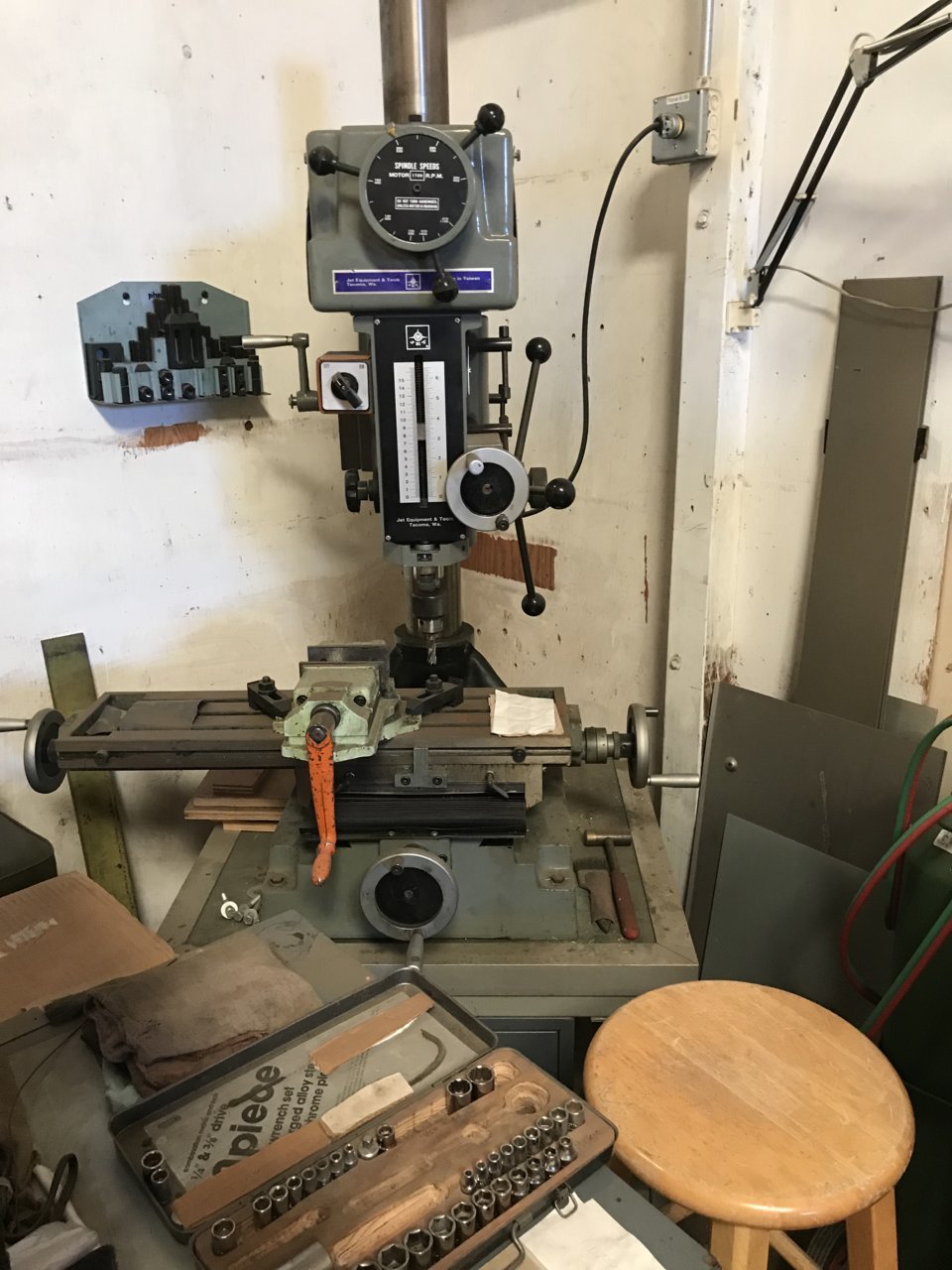

    Guess I have to buy a drill press then. Already have an 1/8" npt tap. My water neck on the engine has an unused boss too I guess I could do both.

    I have one at home or there's one at pops shop in Phoenix. If you don't want to by a drill press. You'll need a drill press vise also.

    Someone ssy they need something drilled
