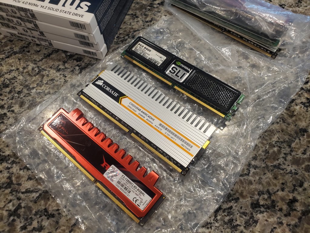

    Do you think I should upgrade my ram too
