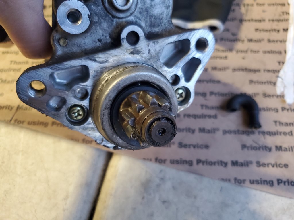

    I hope you don't have to replace a starter on your GX but if you do I suggest you -
    Drain your radiator, and drain the block (use the driver side drain, there's one on each side)
    DO remove the coolant bypass pipe that goes over the starter; it along with the wire harness gives you almost no clearance to get the rear starter bolts out
    DO purchase two gaskets for the bypass pipe you removed, they're one-time use only
    DO purchase misc vacuum lines like that for the PCV and a few others
    DO use a ton of rags to not only block the ports on your heads but also to capture the coolant you'll lose from disconnecting your heater core as well as the two fuel lines on the driver side
    I just need to put her back together now or at the very least get the starter bolted in place and the intake manifold upper/lower back on.

    I would say that the starter gearing was worn out. Now, you can feel good about getting to the root cause of the problem. If that hose was the only casualty, then you are doing great!

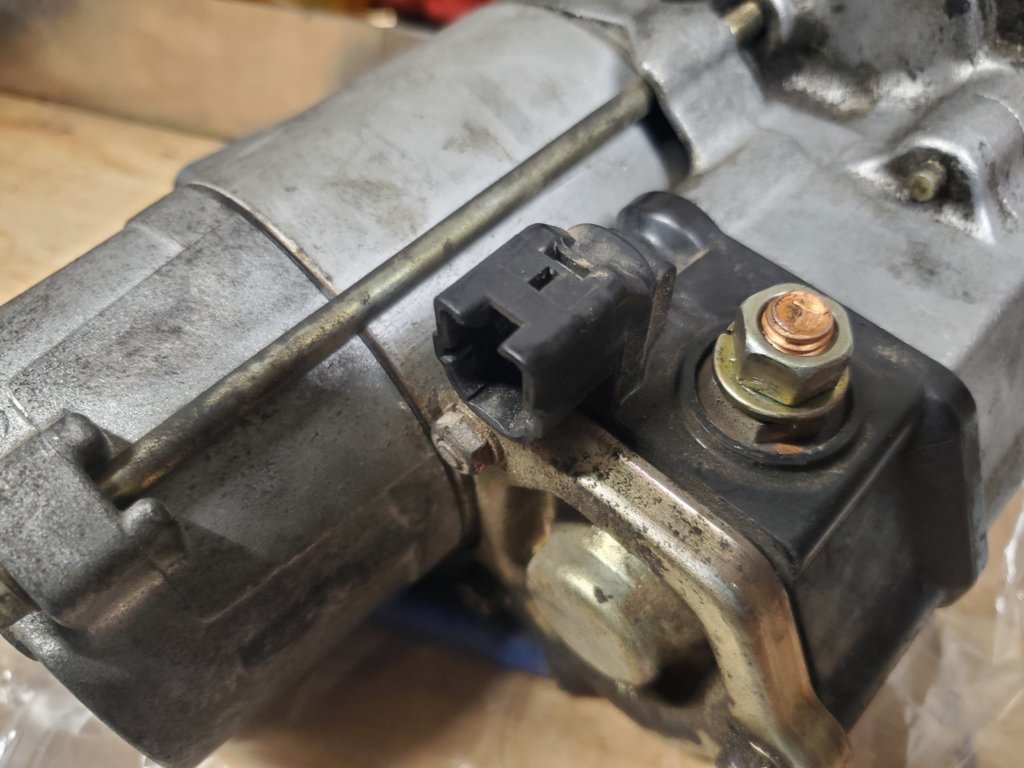

    No. My damn starter's terminal was broken and I didn't even notice it cause I didn't take it out until now
    Fuck me
    It's this plug (old starter)

    I've had mine break before. I grabbed a big piece of shrink tube and push the connectors back together and then shrunk the tube back onto it as a good mechanical means of holding it together

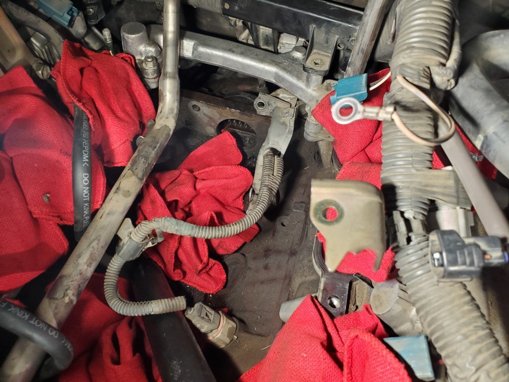

    Am I losing my mind cause I can't find anything to plug into this port on my thermostat housing?
    It looks like the coolant temperature sensor NEXT to it but I don't recall disconnecting anything there?

    That appears to be the one they use for the gauge. Maybe see if it snapped off in the wire popped back into the loom

    That was my thought, the sender being a single wire plug.
    I couldn't find anything unplugged or dangling anywhere from the harness, driving me nuts.
