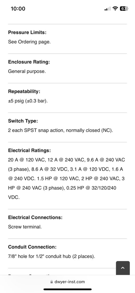

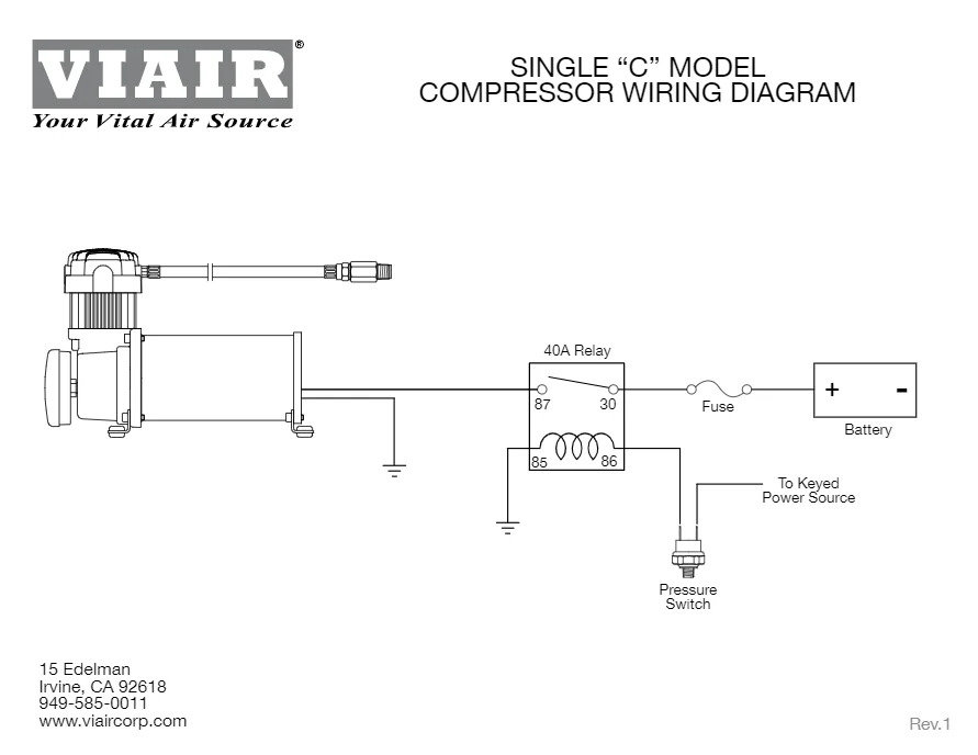

    Talked to a dude that said a pressure switch would work with a 12V dc power source, but I don't see it here. Am I missing something?
  14. Dec 17, 2024 at 9:04 AM
    Speedytech7
    Feb 20, 2014
    #123587
    58,528
    FCQM+VG Cheney, Washington
    It's less Tacoma and more mod
    it's rated higher than your control voltage so should be okay
  15. Dec 17, 2024 at 9:05 AM
    JKO1998
    JKO1998 Well-Known Member
    Jun 2, 2015
    #156578
    53,127
    Utah
    So it should work fine power wise? Why can't it just say 12v
  16. Dec 17, 2024 at 9:07 AM
    Speedytech7
    Feb 20, 2014
    #123587
    58,528
    because it is implied, it is rated for .25hp load at 32/120/240 vdc already. You're just controlling a relay/solenoid with it right?
  17. Dec 17, 2024 at 9:22 AM
    JKO1998
    Jun 2, 2015
    #156578
    53,127
    Utah
    Relay yea
  18. Dec 17, 2024 at 9:23 AM
    Speedytech7
    Feb 20, 2014
    #123587
    58,528
    Yeah you're good then, that switch is way overqualified for that duty haha
