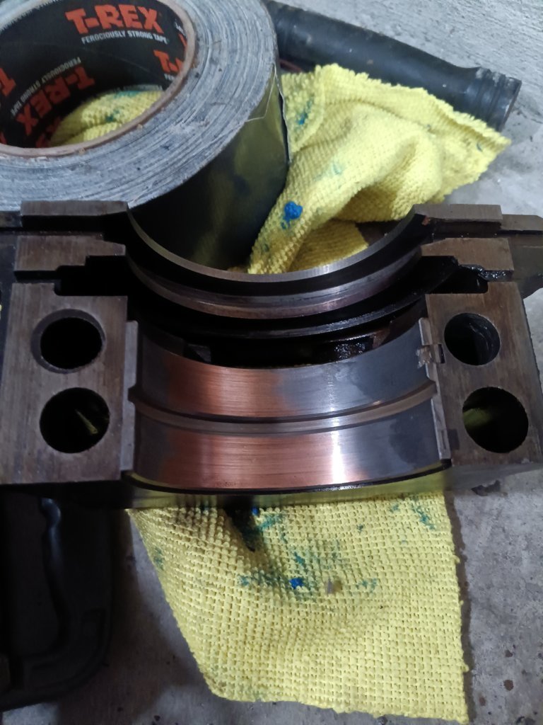

    There was about 1/2" of glittery sludge at the bottom of my dodge 318's oil pan
    It makes no clattering or knocking noises and runs smooth fires up first second of cranking and runs strong
    The original timing chain was the sloppiest thing you've ever seen though
    I have the oil pan off and none of the bearings are loose... I looked at the cam when the Intake was off... none of the lobes were flat
    I'm at a loss what do you think... it's from 1985

    Run thick oil until she croaks. 10w-40 is the life blood of a shitty old Mopar. It's a 125hp V8 it's not super stressed so even with huge oil clearance thick oil can hold off the inevitable for a while. If there's shit in the pan it's coming from somewhere though, might as well just spin some bearings in it next time pan is off. Should take a few mins

    She's got some wear and more than it's fair share of abrasives have gone through the oil haha
