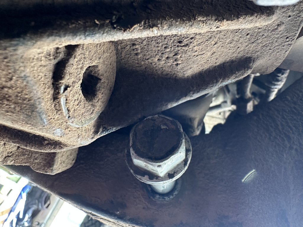

    Went to do a quick 15 minute steering rack bushing replacement
    Except the main 22mm bolt is hitting my front diff and can’t come out thanks to my diff drop :frusty:
    Guess the otres are coming off, man this was going to be so quick and easy, hadn’t even got the jack out

    I had the same thing happen. I was able to just grind down the flange on the big 22mm bolt head and slip it by the front diff.
    How much it gets blocked though probably varies a bit truck to truck, diff drop size, etc.

    Yeah I think I’d have to cut too much, it’s hitting the head let alone the flange

    I mean it wouldn’t be much off the head, how bad would that be? Just a bit of a low taper fade
    Taking off the otre didn’t get enough slack to slip the rack off the bolt

    Yeah I think you're good to just grind that down. Looks like you'd just have to grind off one side of the flange and not the head at all.
