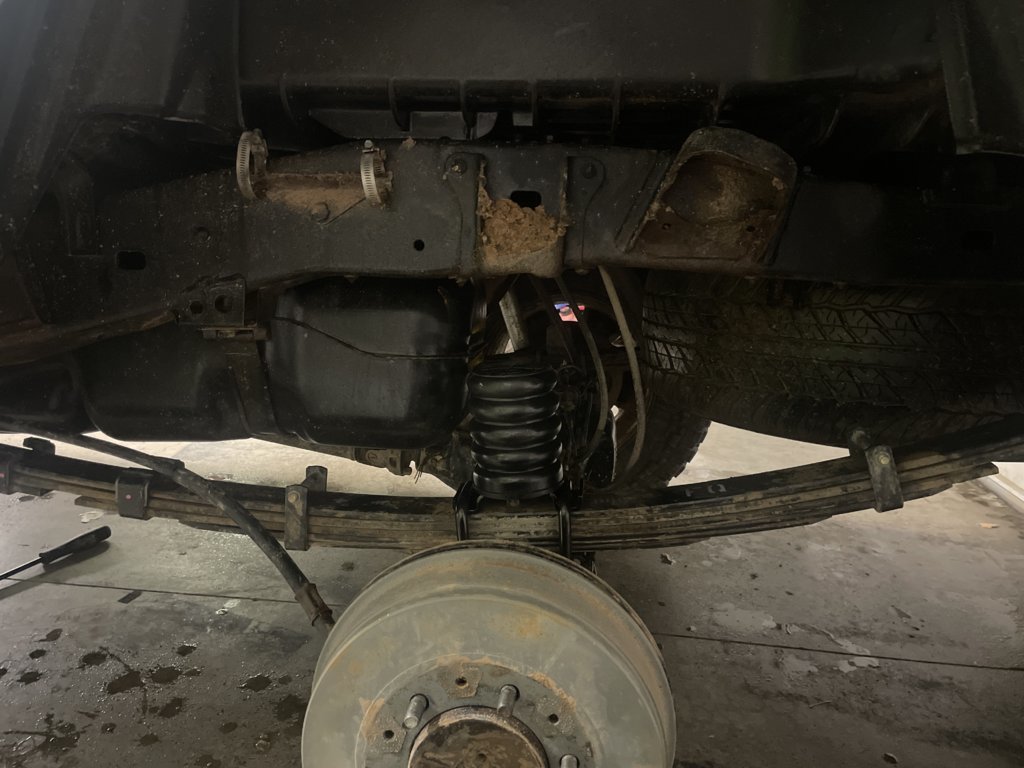

    Back together minus the shock, on one side anyway.
    also, brake sensor did not fix the park issue so that's fun

    It's less Tacoma and more mod
    Are those the sumo spring knockoffs. I've heard they work pretty good for guys that regularly carry stuff in the bed

    Utah
    Yeah, guess we will see how it goes.

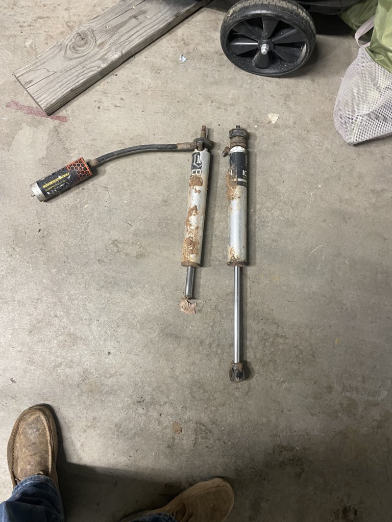

    Wonder how that shit happened

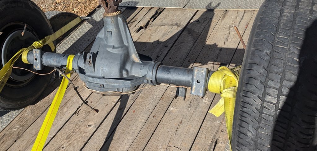

    at a glance looks like the perches are inboard from factory and set up for about Toyota width. really crossing my fingers that it's basically a ready to run setup :D PXL_20241230_192453204~2.jpg

    shaft looks bent, is your shock limiting up/down travel?.

    Definitely not factory welds hahaha. But thatd be ideal if you can literally just throw it under and attach leaf springs and brakes. Is it locked?

    correct. the factory perches are also cast type lol
    it's either spool or welded

    The broke shock side has a bump stop, the no hose side has nothing

    can still bottom out the shock with a bump stop if the shock is the wrong size lol
    cheap way to check is to flex it out with the shocks disconnected, measure max extended/compressed length and compare that to the shock
