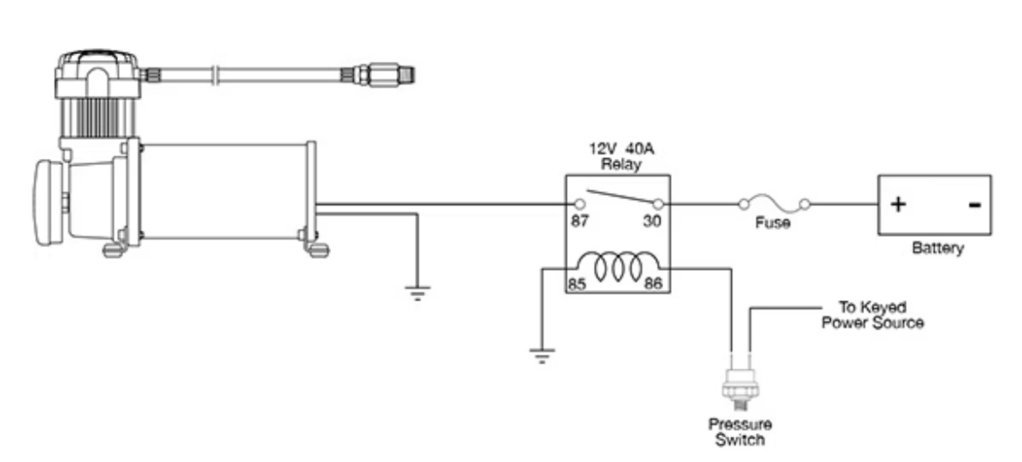

    Back to this
    I have the line spot going to the power switch and the motor going to the relay, keep blowing the fuse wut

    Line spot? Draw on the picture because your words ain't working anymore

    How I wired it
    Pressure switch
    with the other pressure switch

    Should it be motor to motor instead of line to motor?

    Okay what is the motor? The compressor has a motor is that what you mean. If not I need the specs on this motor because that switch is switching a lot if it's switching a relay for the compressor and a whole line of a an electric motor. That electric motor if it's not the compressor you're talking about should also have a relay then the switch could do both

    I'm just saying motor because that's what the switch says on it.
    The compressor is the only thing here and it's positive line goes to the relay like above

    Oh okay I think I get it. Yeah it should be motor to line. I didn't realize this thing cuts both sides of a circuit. This is kind of an overkill pressure switch, this is what you would use on like a 240 volt air compressor. Did you wire a ground specifically to the switch as well. Because it might be neutral bonded in which case in a DC circuit it would basically just make a short and blow the fuse.

    Yea the switch is for an air compressor you would have in your garage or something, but they said it would work for a 12v set up also.
    I'll add a ground and see if that fixes it
