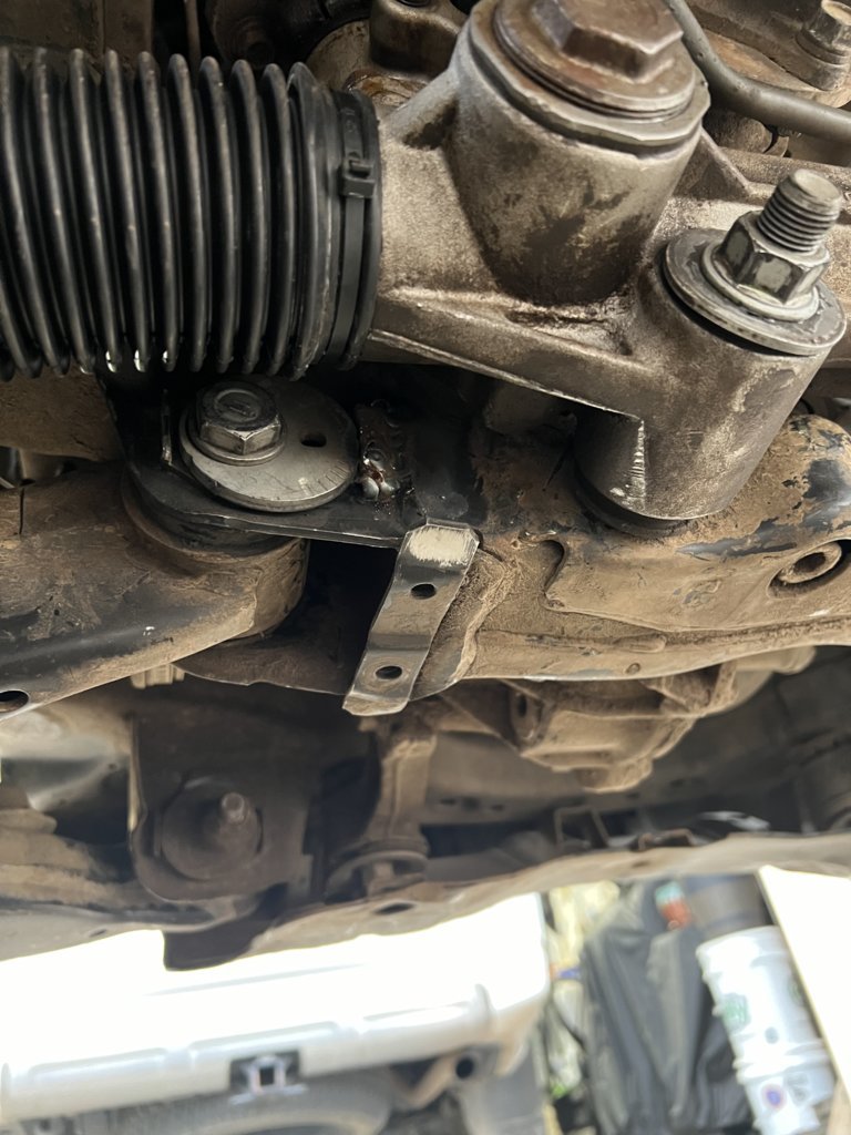

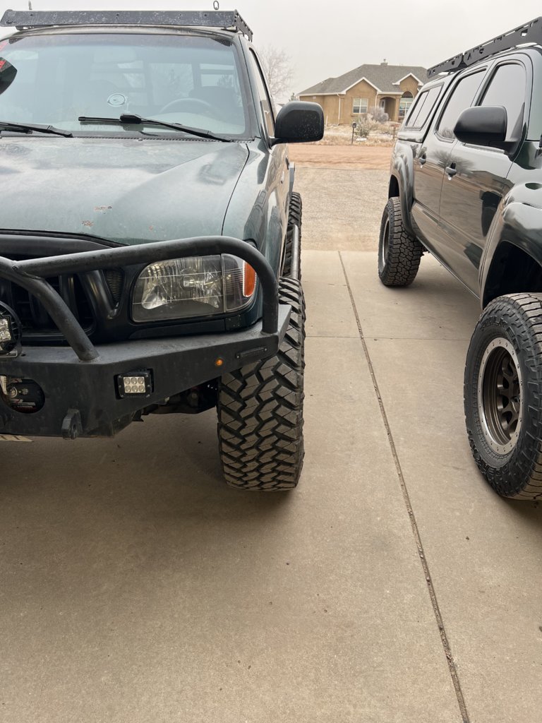

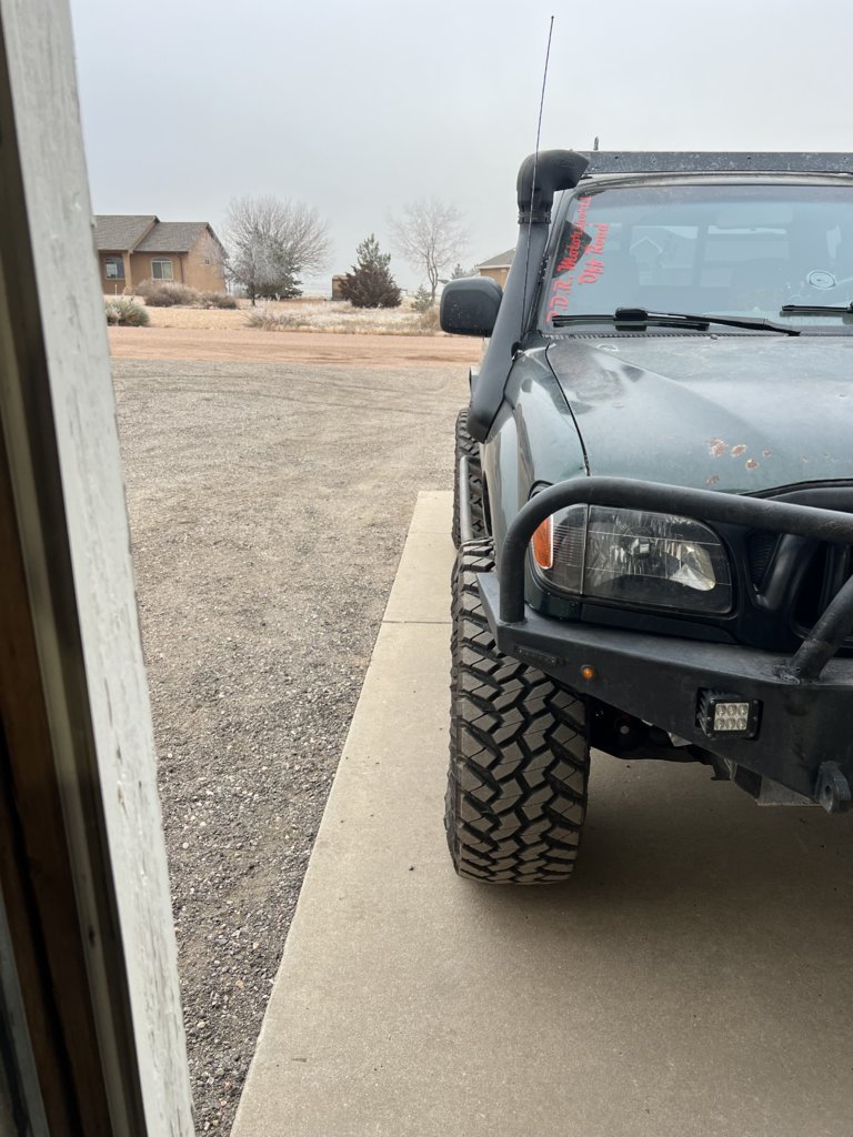

    Just fixed my alignment issues after wheeling it pretty hard last summer. Drive side rear most cam tab had been mushed by the cam. Bent it back and reinforced with some 1/4” key stock. Did a rough alignment with an angle finder. Adjusted caster by just maxing out the rear cam outward and front cams inward. Wanted all the caster I can get to keep the 35s out of the firewall. Seems to be within spec. Toe is wack. I have it set pretty good but my steering wheel is clocked around 45 degrees counterclockwise. Driver OTRE is showing a lot less threads than passenger.
    I’m thinking after a hard hit I took on the passenger side directly into a boulder, the rack jumped a tooth or two to the driver side. Anyone ever heard of such a thing? Rack has a good bit of rotational play but no leakage and really no side to side play. The truck drives surprisingly well down the interstate. A clocked steering wheel doesn’t bother me really. Just curious if anyone has had similar situation or input. I’m fine with a crooked steering wheel. Hesitant about taking it to my alignment guys. They are good at their craft, but like to have parts in pristine condition, I.e. no hard miles/wear. So I feel they will deny aligning it again.

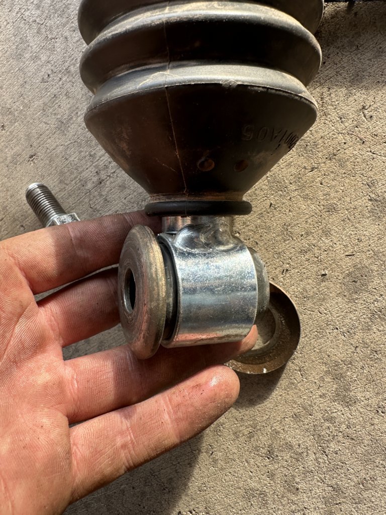

    Are the shock bushing washers supposed to go cone-in like this or the other way

    You want the convex portion touching the rubber

    Ok so I’ll turn it around
