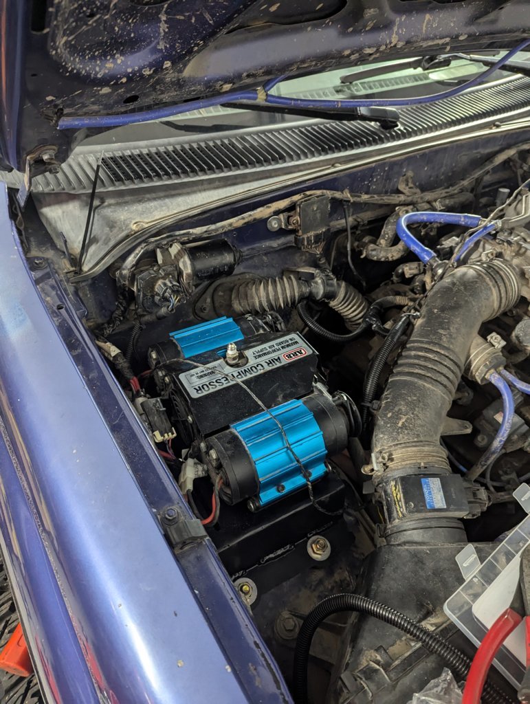

    I was hoping to take advantage of Kira's work and not have to do any design myself lol. I suppose it'll be a good project for me.
    I'd have to defer to y'all on details like what gauge metal is best. I could weigh the compressor if that would help.

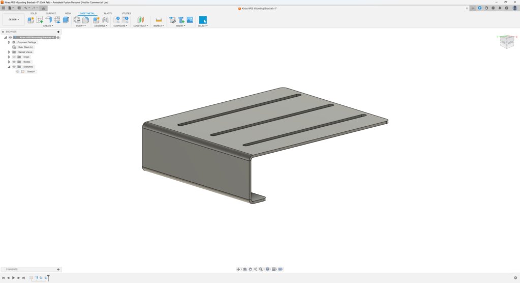

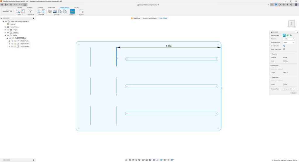

  7. Jan 6, 2025 at 6:05 PM
    Kwikvette
    Feb 27, 2019
    #284735
    81,710
    Fresno County
    4 run, 2 don't
    So it only went this far as design goes.
    Bad memory but I think I was using dimensions written on either cardboard or a napkin :rofl:
    You'll need to add the second leg/foot, and figure out the exact spacing for the holes for mounting.
    Dimensions are as follows -
    About 9" in length for the top plate, at 7" wide
    The flange is approximately 2" tall and the foot is just over 1" long.
    Slots are 2.3625" apart center to center, which is an odd number so I'd wager to say the actual measurement is 6cm?
    That puts the top slot and the bottom slot distance at 12cm center to center. Slots are 7" long and 0.29" wide.
