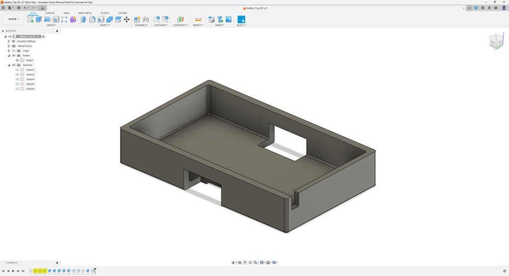

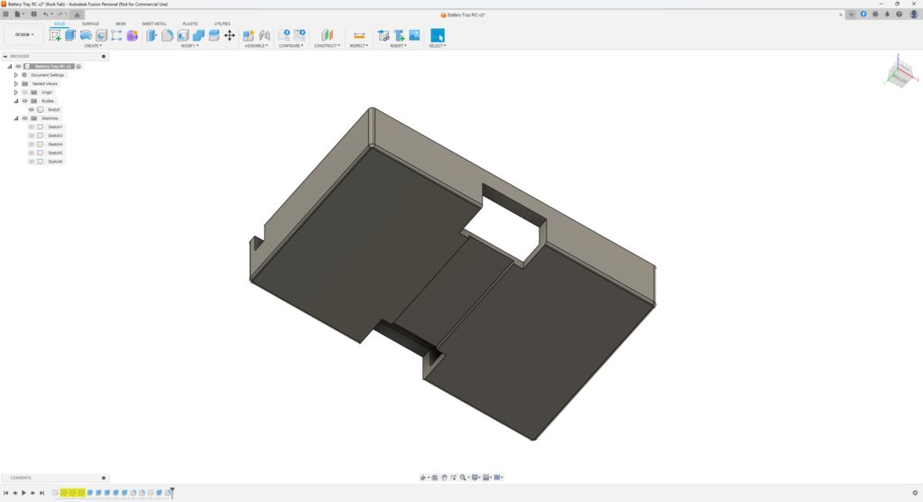

    So what I did yesterday as far as adding slots and shit was indeed the correct method for working on a 3D item.
    Added that "slot" underneath so it centers over the crossmember in my RC.
    The large notches are for clearing the shock towers.

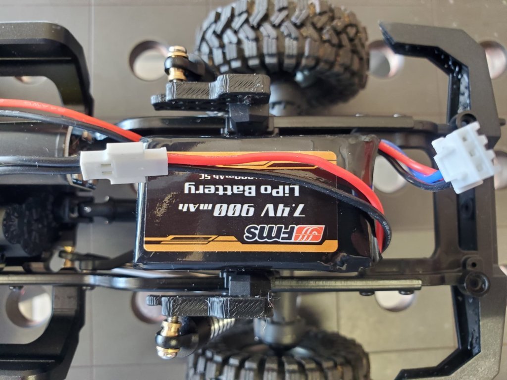

    Here's the battery held by double sided tape where the new tray will go.

    I thought by adding a sketch on a different plane and extruding it, was a band aid to the real solution
    Apparently, that is the appropriate way to do it so I had figured it out already by accident :rofl:
    Someone just confirmed it for me
    But he also shared with me adding the fillet so that it adds strength from the interior floor to the interior wall
    Just wanted to make a setup with everything I needed so Zane didn't have to "fix" stuff for me
    It's better I do it right the first time around

    @time623
    If you decide to dabble in Fusion for whatever reason, you just need to ensure one thing when dealing in 3D
    Just make sure all extruded sketches appear on one body
    The moment your model shows two bodies, then Fusion will recognize the item as two separate pieces instead of one
