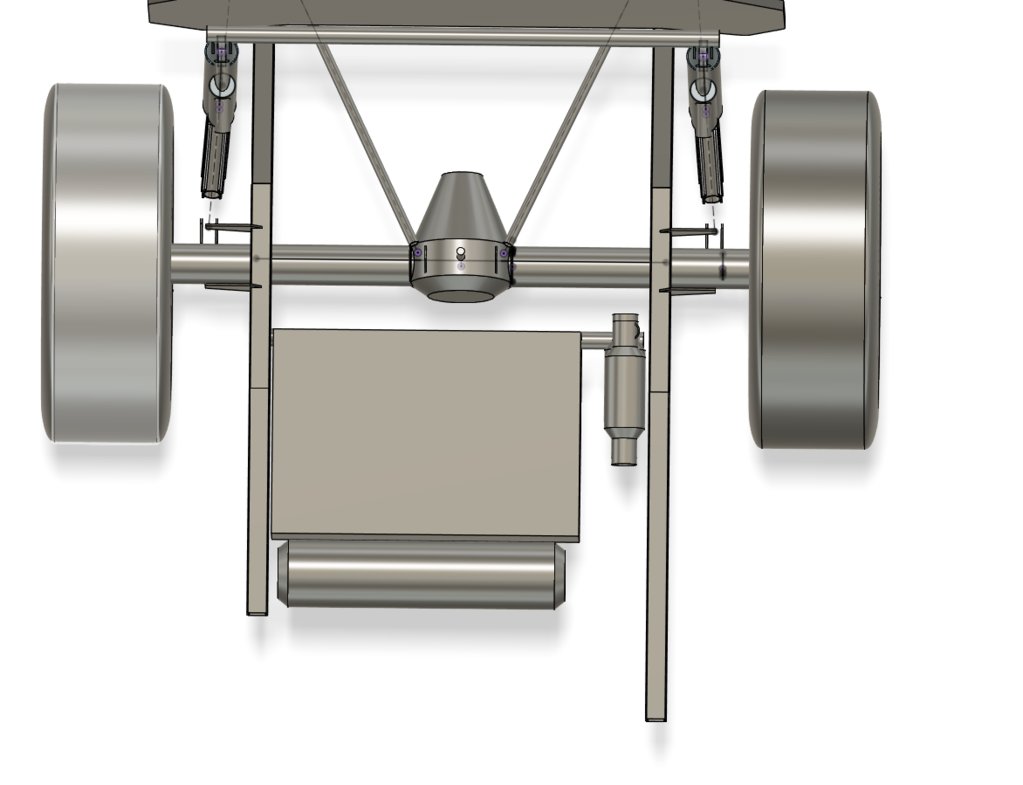

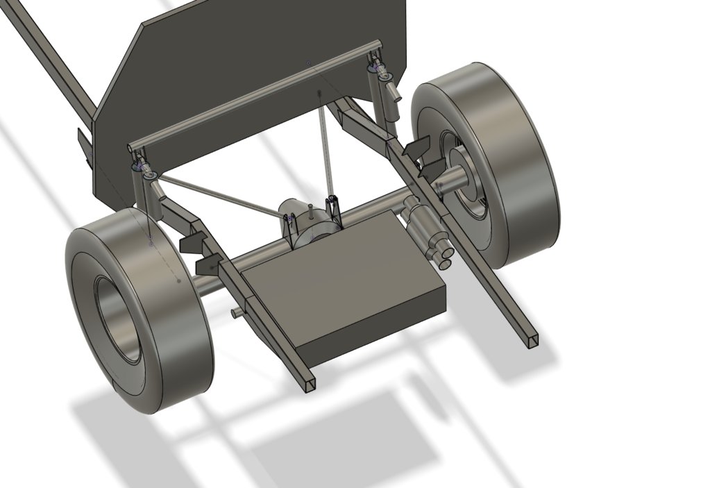

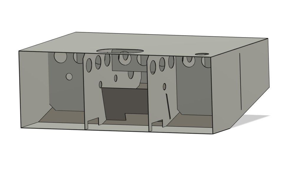

    speaking of fuel tanks... hopefully I have time this weekend to make this ~24gal unit to go where the stock spare usually sits
    I do still need to finish welding the control arms :anonymous:

    That's a nice spot to put a tank, the Chevy one fits so well though I don't know why you'd go to the effort of making a bespoke one.

    lol which chevy one, all I've seen is the ford tank and its unbaffled, you can run a fuel bucket, but that is less effective off-road than on

    67-72 chevy truck 2nd tank, has some slosh baffles but really not that important to just feed your main tank

    ah, this will be my main tank tho.

    Oh, is that going to be enough capacity? Another one I've seen people use is the 90s grand cherokee tank, it's plastic though so you need a skid for it

    I get by just fine on 18 now, 24.5 is a healthy upgrade

    Yeah that's pretty good increase. I really want to do the ford 32g saddle tank when I get this camper going since i won't need that space anymore. Free me up for a four link

    that exactly what I'm doing... trying to package exhaust and an air tank back there too tho.

    You know I'm no expert, but I think your frame rails should be the same length :luvya:

    I almost added an explanation... but I will leave you all to worry about my competence :crazy:

    What's the air tank for?
