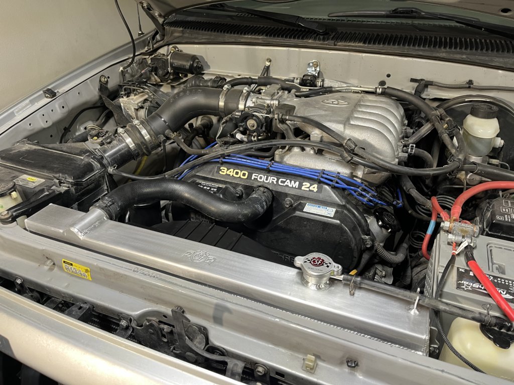

    I knocked this all out before midnight yesterday which is fast for me. Not sure what I’ll do with the Koyorad. I also have a manual transmission OEM Harrison radiator in my attic.
    I might go ahead and regear the truck over this upcoming 3 day weekend I have. It’ll be a harrop rear and Truetrac front.

    Clean engine bay!
    What all got done?

    When I was younger I washed/waxed this truck 2-3 times a month and cleaned the engine bay twice a year :bananadead:
    Transmission drain and fill, adjusted the bracket for my auxiliary transmission cooler external thermostat, rerouted/added trans lines to the radiator so the ATF warms up with the radiator then goes to the aux cooler, swapped from a Koyorad MT radiator to this CSF with a beefy internal transmission cooler, and of course a coolant drain and fill. Didn’t have to remove the ARB which was a huge relief. The winch makes that a much bigger pain now.
    Ideally the transmission won’t have cooling issues anymore. Deleting the transmission trans cooler with that Koyorad in 2021 was a bad move.

    Enviably clean.

    @04Pre_Runner Also reminds me my truck is still on the OG radiator. Which is equally impressive and not so good.
