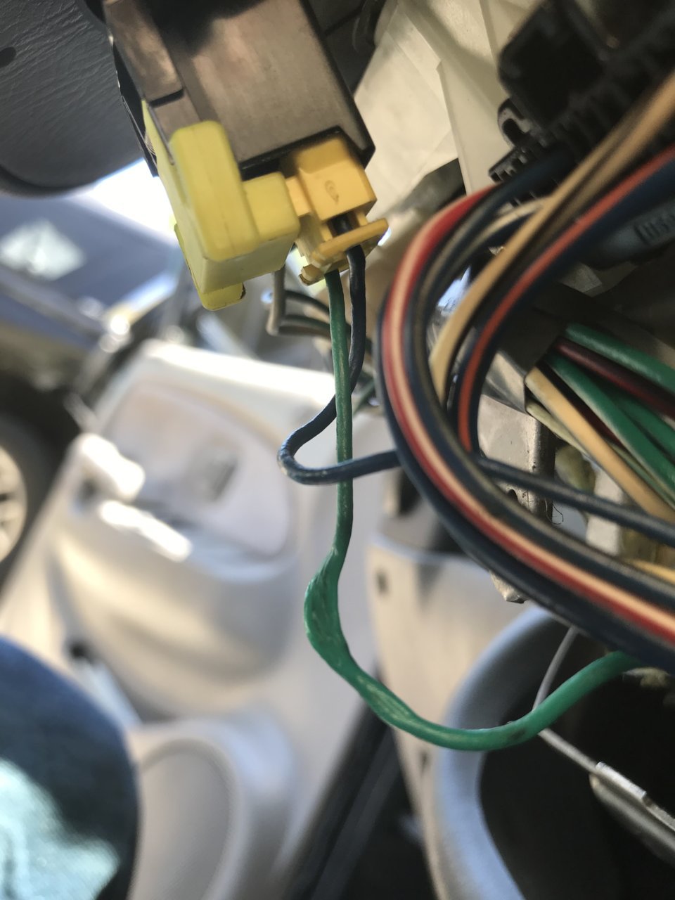

    Just make sure you disconnect the battery before you do it.

    That’s part of the SRS sytem? Does it have a yellow tracer?

    Yeah that wire goes to the yellow connector i can get a bette rooc if you want

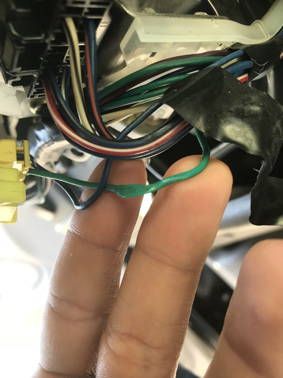

    Can you confirm the green wire has a yellow tracer? All SRS related wires will have a yellow tracer.
    I can see what the wire does if you can tell me the wire color.

    I can’t tell if that has a yellow tracer or not, is it solid green?

    I thought SRS wiring just had to have yellow connectors and looms, not necessarily a yellow stripe. Either way that is definitely SRS related because of the connector being yellow and having a safety lock.

    Its solid green but goes into a yellow connector

    On most of the Toyota’s I’ve worked on I always see yellow tracers for airbag related systems. The IS300 clockspring harness has yellow wires, and the seats from my ES300 has yellow tracers for the bolster airbags.
    Maybe it’s a later Toyota thing. I don’t recall seeing it on my truck.

    That connector goes to your clockspring?

    Im assume thats where it goes it just plugs into the back of the wheel
    I have code b0102 short in D squib circuit

    I just realized I don't know any of those codes.

    Me neither. But that code does make sense seeing that crushed wire, short in airbag squib.
