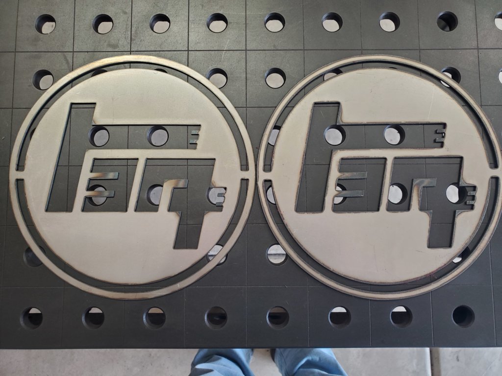

    @Bandido
    Finecut on the left, general cutting on the right.
    Both cut at the appropriate speed and amp rating for 16 gauge.
    Big difference in heat input. And when doing intricate items with a lot of detail close together, the parts remain flat as hell.

    I made that fuel tank out of 16ga, actually tries the high amps super high feedrate trick, very meh with the results.
    if anything my THC and pierce delay settings were getting all tripped up trying to do that without any practice.

    Yeah that's 16 gauge for ya.
    I ran the left part at 32 amps and 150ipm.
    On the right it was like 45 amps and 210ipm?
    Both at 0.5 second pierce delay.

    yeah I've been having the pierce delay not seem to post right out of fusion since... I was running ~37amp 180ipm, dross was a little inconsistent, built up on longer cuts but not shorter.

    The way the post processor is written, pierce delay doesn't begin exactly at torch firing or something like that.
    0.5 is the lowest you ever want to use and most machines don't have the output voltage to penetrate near instantly. With my PrimeWeld, I had to run 0.9 for 3/16" whereas now I use 0.5 for 16 gauge up to 3/16".
    For most machines (non-Hypertherm), you generally want 0.6 for 16 gauge, 0.7 or 0.8 for 12 gauge, 1 second for 1/4" and so on.

    I'd been running .7 for just about everything with no issues except for reducing it to .5 for cutting the fuel tank parts out... now despite changing it in fusion it doesn't seem to have changed in new programs, or it has and I was just lucky for the past 2 years lol

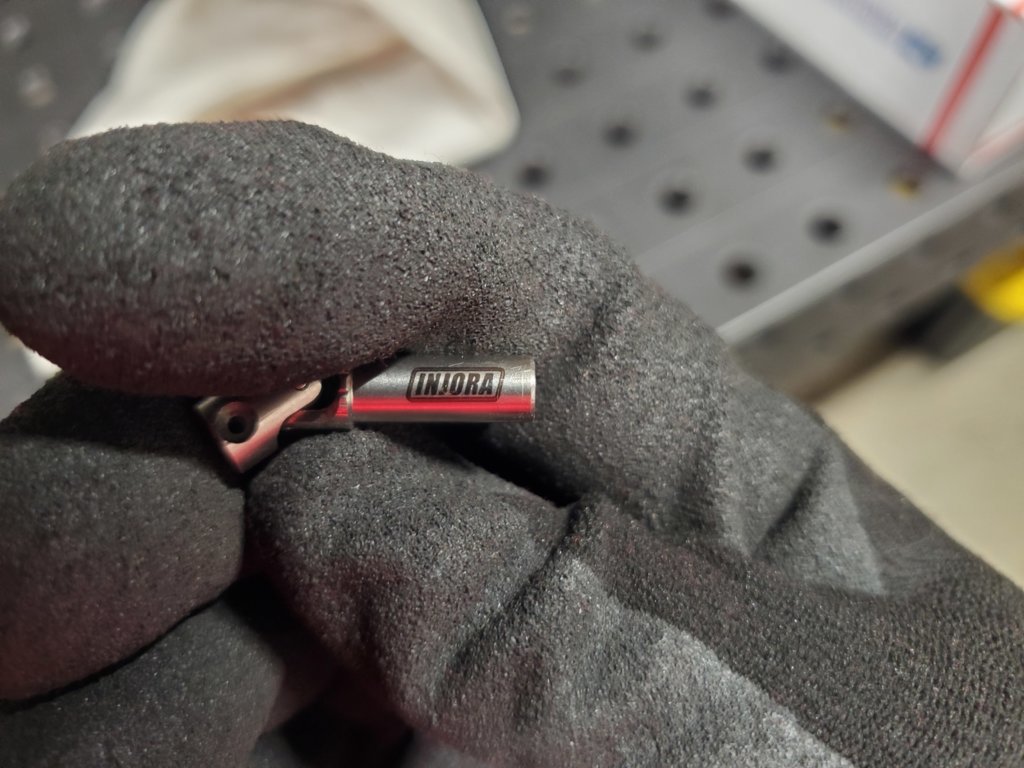

    Poor man's lathe; @Abeyancer would be proud :laughing:
    Cut this down with my mini cut off tool, squared it up, beveled the edge, and she's as flat and square as I can get it.
    The front drivetrain "wiggle" is completely gone on my RC now.
