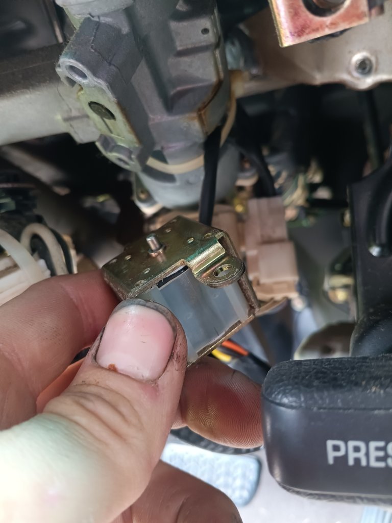

    Does anyone know how this is supposed to work?
    The key won't go to the lock position most of the time with it installed

    I figured it out... the shifter has a switch that tells that plunger to go up when it's not in park to lock the ignition in accessory so you can't take the key out without it being in park

    yup that’s it, id probably check the transmission shifter cable adjustment
